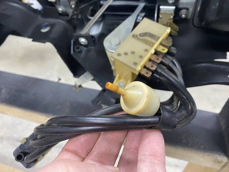

All the positions are controlled by vacuum so first ensure the main vacuum feed going to the control is connected. The switch will then open/close doors when in each position. This pic is the rear of the heater controls on my 74. The white check valve is the feed from the engine compartment which will go to manifold vacuum.
