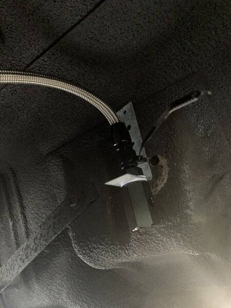

What’s the fuel pump you’ll be using with the sniper EFI? We used an Aeromotive (stealth 340 I think it was called), this has provision for a vent which we connected to a rollover check valve. I will try and find a few photos, or can take a few next time I’m under there.

Found it - here’s the rollover valve. I went online and found one that matched the AN-06 size line I was running from the pump, I think I got it from summit racing.
