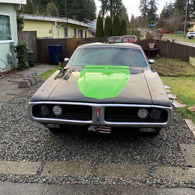

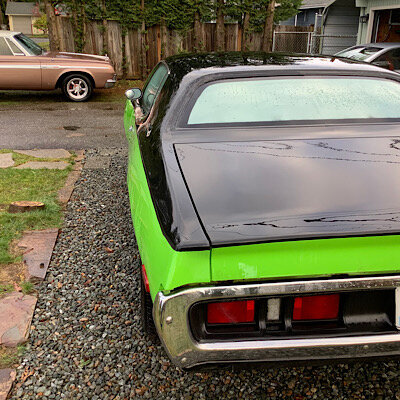

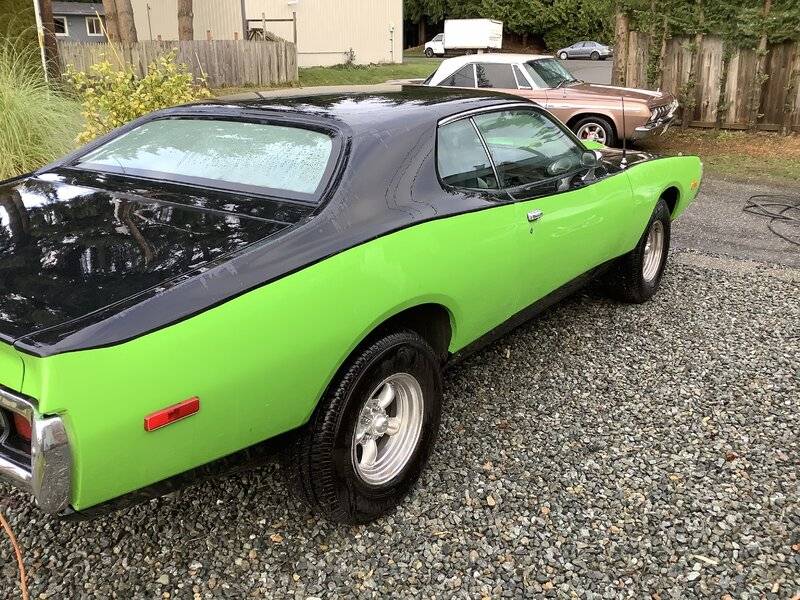

The underside of the deck lid is raining inside the trunk. This has been a real issue and I am not sure what to do about it. When I did the vinyl wrap last summer I also addressed several water issues in the rest of the car including a large hole that was under the lower w/s trim on the left side that drenched the carpet under the pedals. Sealed up the back glass as well.
The trunk weather strip is in really good condition and seals better since adjusting the lid. There used to be small puddles of water in the rear foot well areas from the back window but that has been resolved. I was thinking that all the moisture inside was causing the large amounts of condensation in the trunk, but it seems like that isn’t the main problem.
I also have car covers and that’s not helping either. Is there something I can try??:BangHead::BangHead::BangHead:

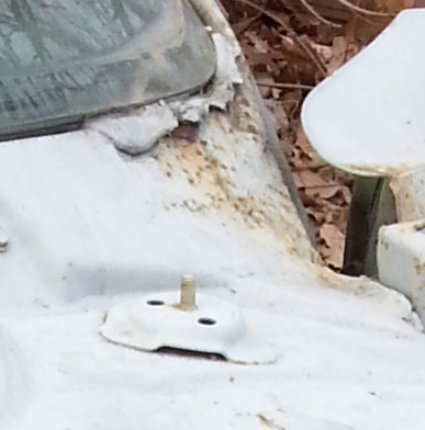

Pull front corner A pillar chrome, check "overlap" of cowl is sealed commomn issue: check cowl center drain inside wall, found holes there from years of debris stuck in drain: the rug moisture could be causing trunk condensation, needs air to escape/breath. Hope rugs & underside insulation are dry, if not, need drying asap. GOOD LUCK TROUBLESHOOTING
John

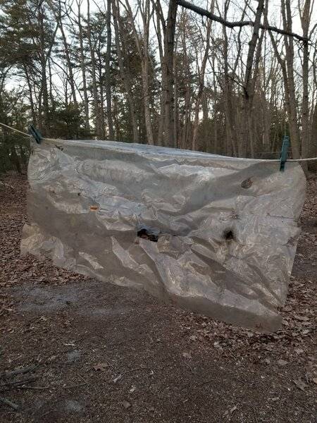

A pillar corner is common, glad that is done; check metal overlap area towards center of cowl just before cowl opening, may look sealed but "sealent" may be hard: check drain's WALL inside car, small rust holes may be present, wetness of carpet at top of trans tunnel dead giveway, USUALLY insulation covers this area inside car: moisture barrier is actually heavy plastic like thick trash bag that is glued (3M adhesive that is black) to metal structure of entire cabin, doors, and behind rear seat back glued to x-beam, along top, bottom and inside wheel wells to isolate trunk from cabin.
Thank you for your help with this issue. I will have to plan on redoing the inside and the trunk areas with some type of plastic vapor barrier. I am considering replacing the carpet now that the inside is dry. Does the plastic have to be glued to the entire piece or can it just be around the edge?
Perimeter and middle areas to hold it in place. Pretty much the way factrory did it. Forget denier (thickness) that was used but going thick with mine, NJ weather.

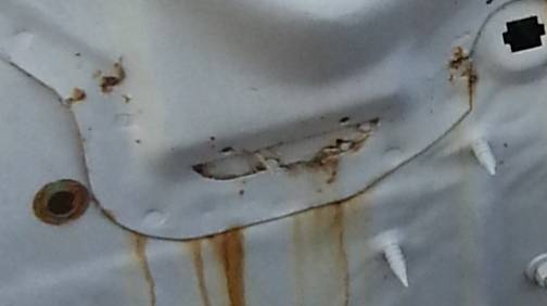

Underdash, check cowl drain's wall inside, arrow pointing to in pic

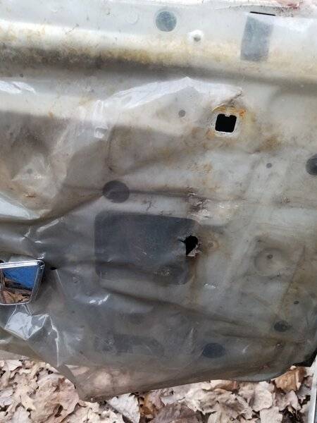

This the vapor barrier on the drivers door that I was refering to: all interior metal on sides & behind seat should have these if not mistaken.
