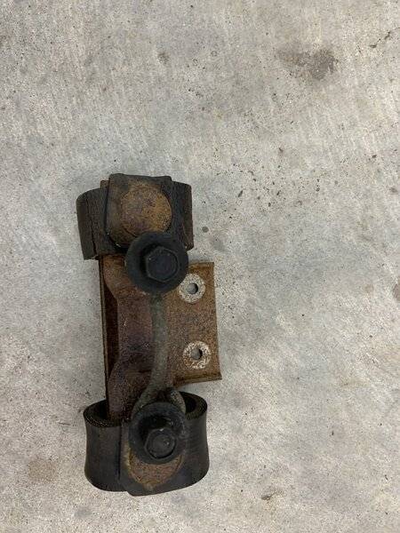

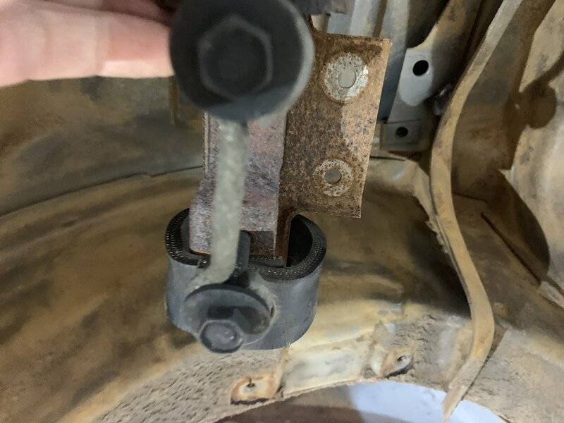

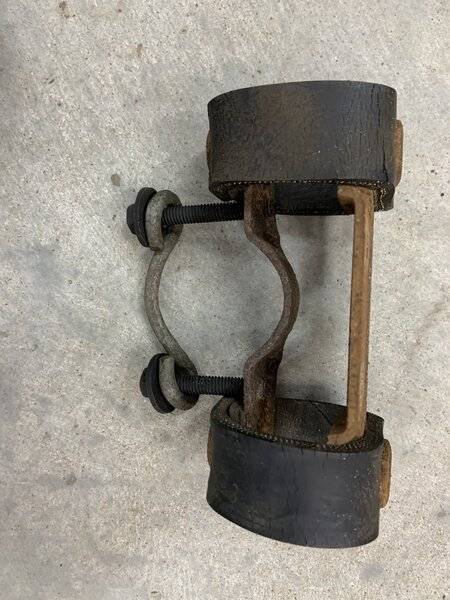

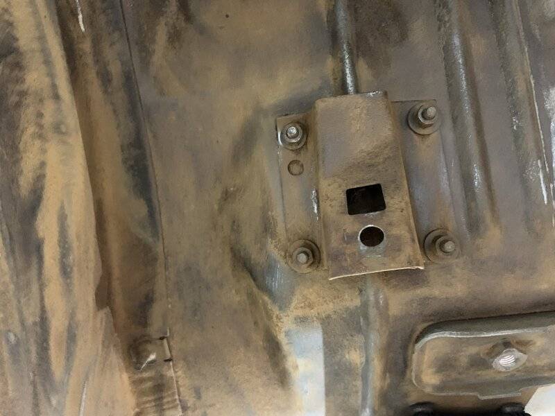

Here is the right mount. It is mounted to the upper shock brace you can see in the picture. The left brace is mounted to the floor pan with 4 nuts. It is a basic rubber strap screwed to a u-nut. Both are available reproduction.
