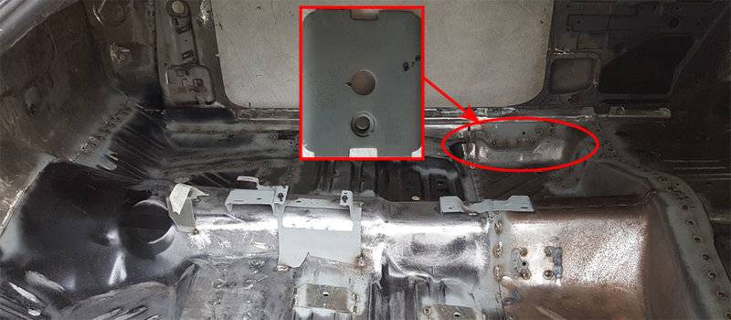

Replacing the floor pans on my charger and i accidentally threw out a part of the old floor where the seat belt bracket is spot welded on the the pans. I welded in the 2 on the rear pans, but having a hard time figuring out where the other 2 go...
Does anyone by any chance have the dimensions or a picture of their general location?

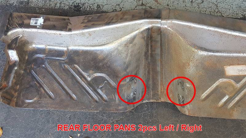

I have these two welded into the two rear pans, it's the other 2 brackets i lost track of. A quick measurement would be very helpful.

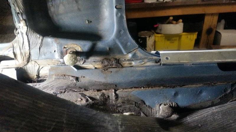

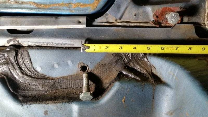

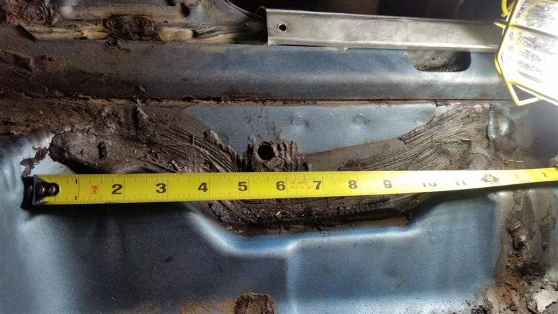

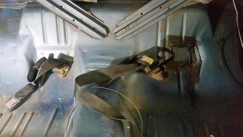

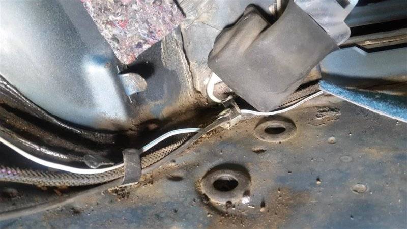

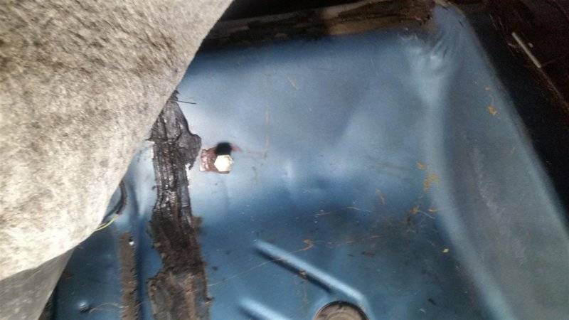

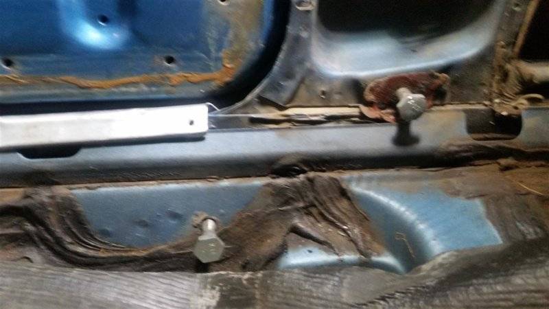

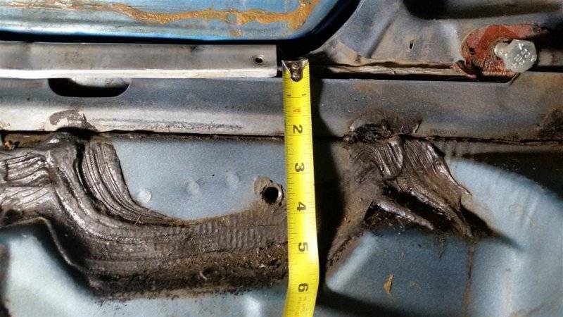

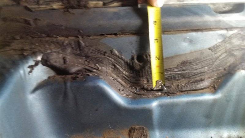

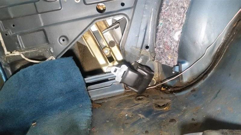

Lets see if some photos will help.
Dvr Front Seat Belt Bolt on Tunnel (Medium).jpg Dvr Side front Outer Seat Belt Bolts (Medium).jpg Dvr Side Rear Outer Seat  Belt (Medium).jpg Pass Side Front Outer Seat Belt Bolts (Medium).jpg Pass. Side Rear Outer Seat Belt (Medium).jpg Ctr Rear Seat Belts (Medium).jpg
Top Left is Drivers Front Tunnel seat belt attach. Top right is drivers side front outer attach points, Left center photo is driver side rear out attach point. Right center is passenger front outer attaching points. Bottom left is rear passenger side attaching point and bottom right is rear center seat belts.

I am looking for this bracket location specifically. by the door somewhere near the rear pan. if someone has a rough measurement, that would be a great help.
