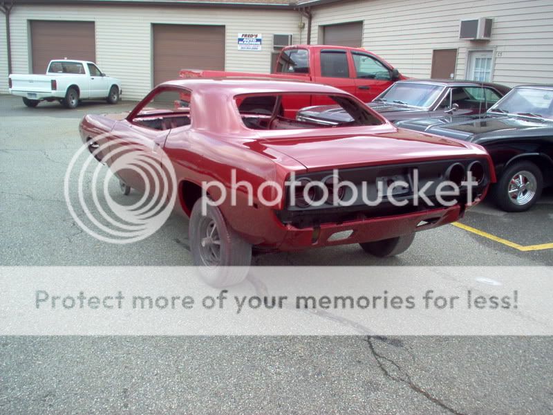

Since Im not doing any B bodies in the shop right now I thought I would share some E body pictures.
The car is a 74 Barracuda. I believe it was a 318, auto. Now set up fpr a 4 speed. The car has been to 2 other shops before ours, Dry stripped twice, Painted 5 shades of yellow, full of runs and dirt. The last resto ended in a law suit that took 5 years to get it here. He had it restripped and dropped it off to us.

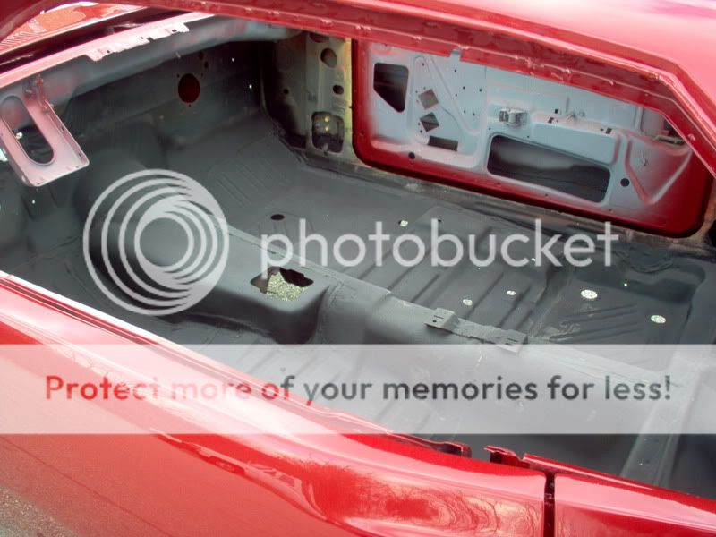

The car had new quarters on it when we got it which needed a ton of straightening. Looks to have had the floor boards replaced and the trunk patched. Anyone with an E body, I must say the Goodmark fenders that are on it are pretty good.

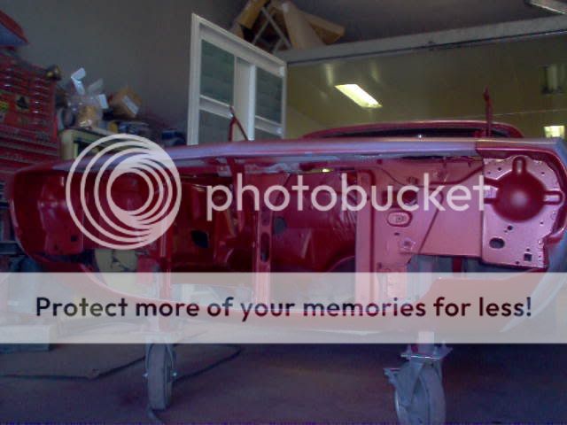

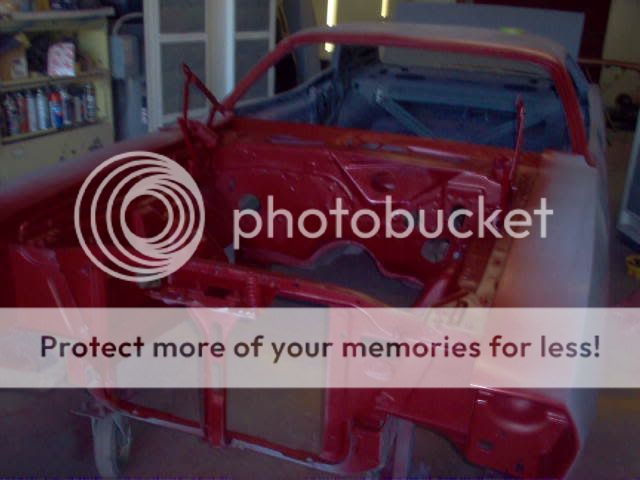

When I started at the shop the car was in its first coat of primer with no sheet metal bolted up front.

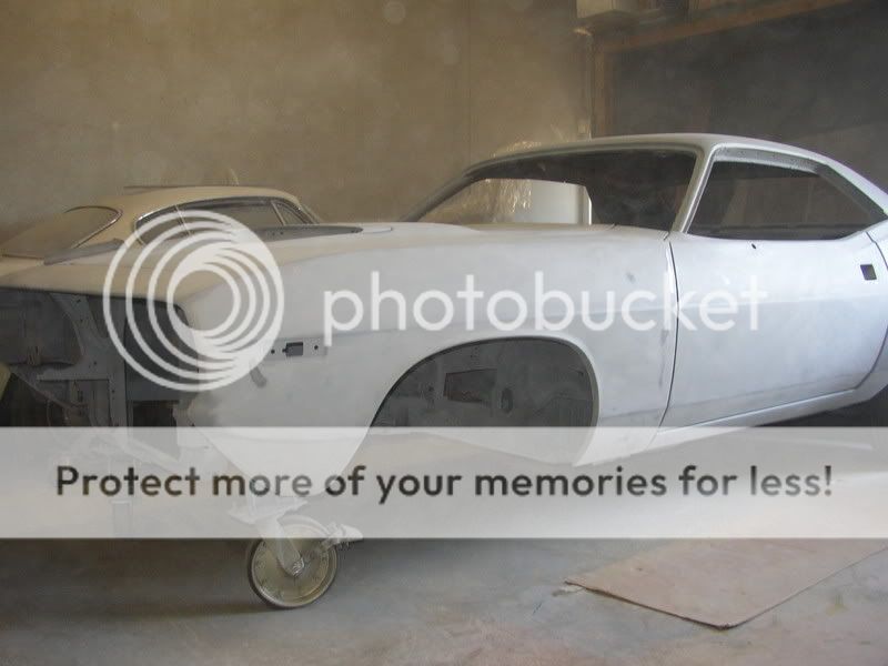

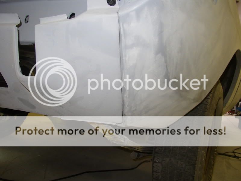

My first step was to start bolting up the new fenders and get it all lined up.

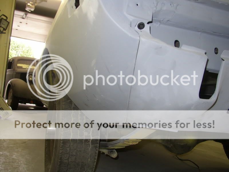

next was fitting the rear valance which was all ready reworked to fit by the last shop. He also brought a new one incase but it wasnt even close to fitting correctly.

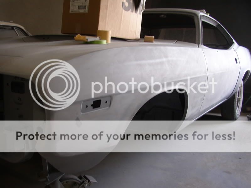

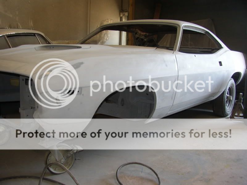

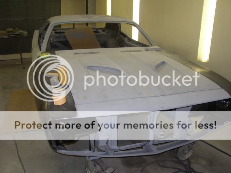

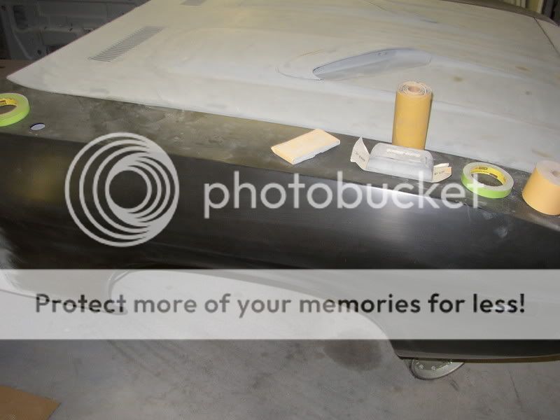

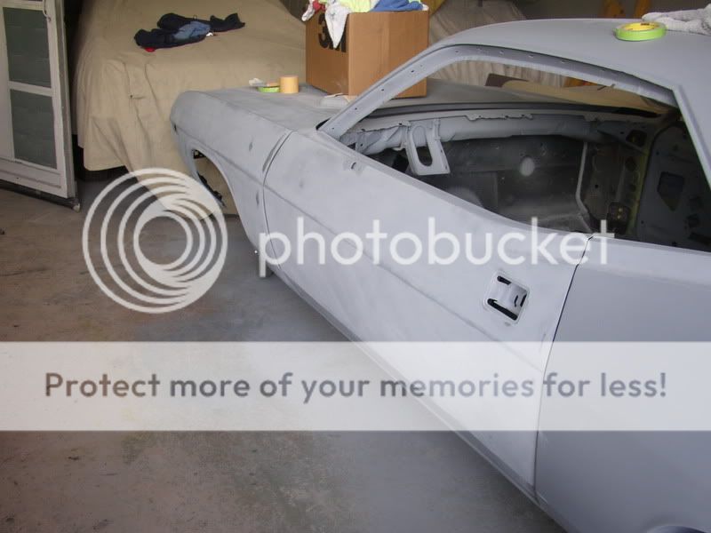

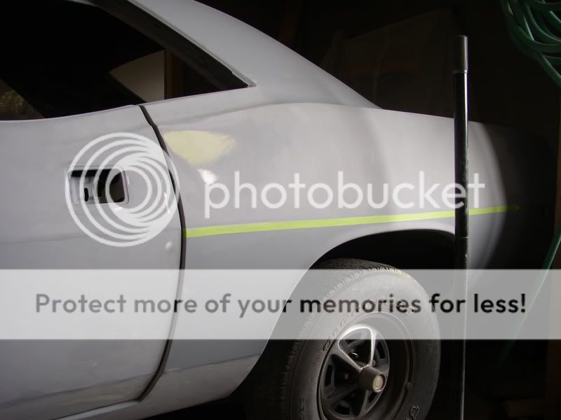

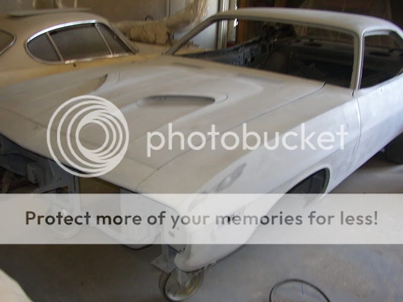

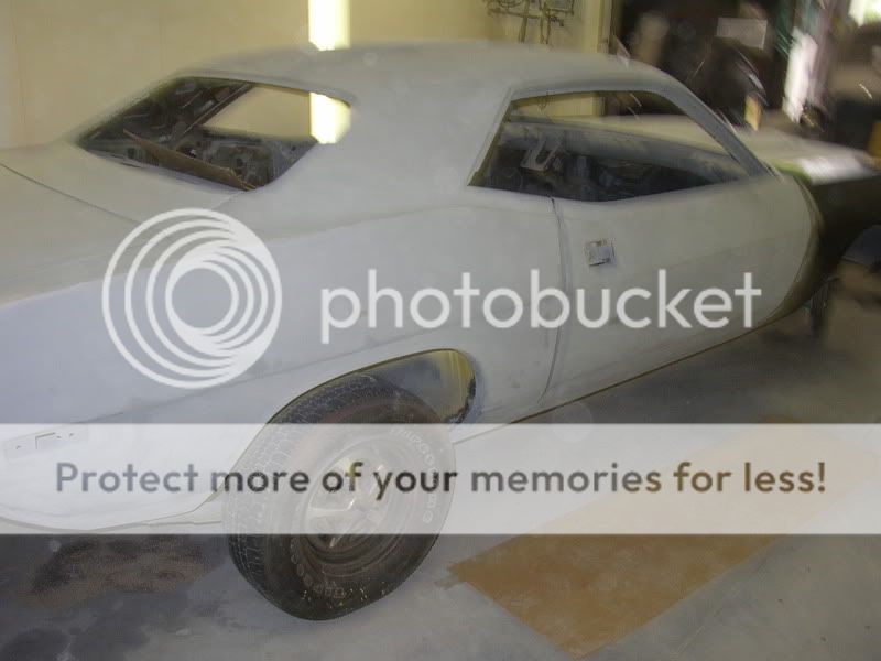

Next I started blocking the car out. I started with 180 grit on a long block. I use a set of Dura-Blocks I bought off of ebay for around $30, they use adhesive backed long board paper and come in different lengths. thicknesses and shapes.

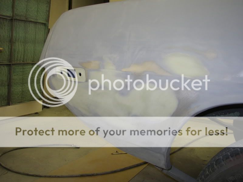

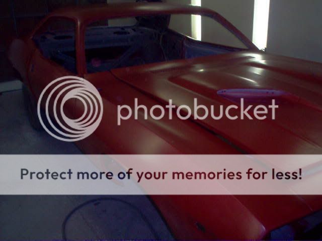

Heres were I am now. I re primed the entire car with a 2K primer and started round 2 of blocking, again with 180.
I run a line of tape down the body line to keep from sanding it down. This really helps make the sharp and straight,
The hood had to be the hardest part to block. It also turned out to need the most work.
Will do. I need to block it out 2 more times still. Then the front end comes off to paint the backs of the fenders and valances. Then back together, Jam it and paint it.

When you do the metal work do you flat file the areas down to 80 then start priming?
I grind it down to metal before doing any welding or 90% of my filling. If theres a small spot that needs a bit of touch up (something that wont block out) I'll put a thin skim over the primer. I much rather do it over bare metal though.

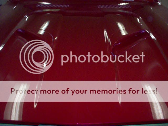

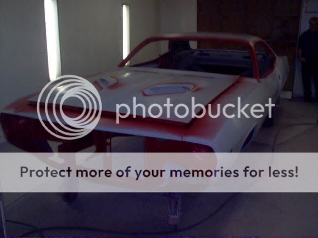

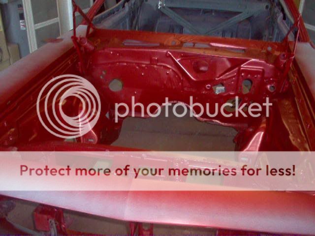

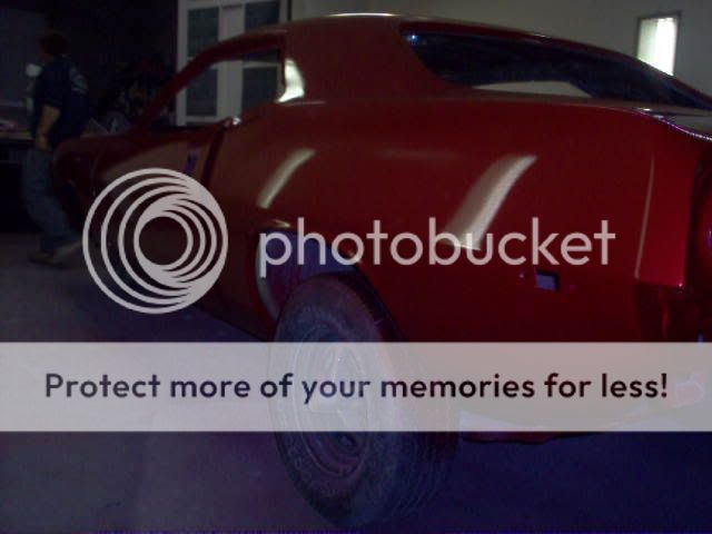

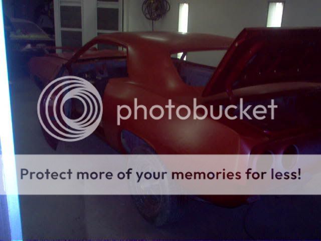

Figured I would update. I blocked the car 3 more times after those pictures, 220,320,400 wet. The primer was all most shiny when I was done. Its amazing paint will stick to such a smooth surface but the shop next store goes to 800 wet before paint.

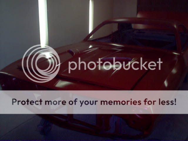

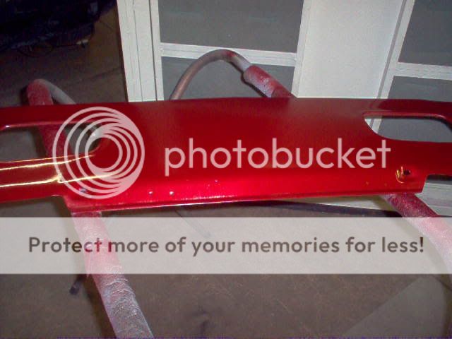

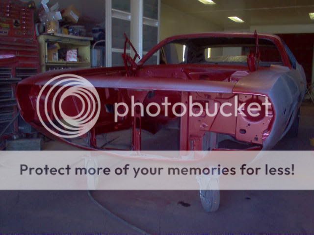

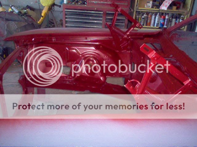

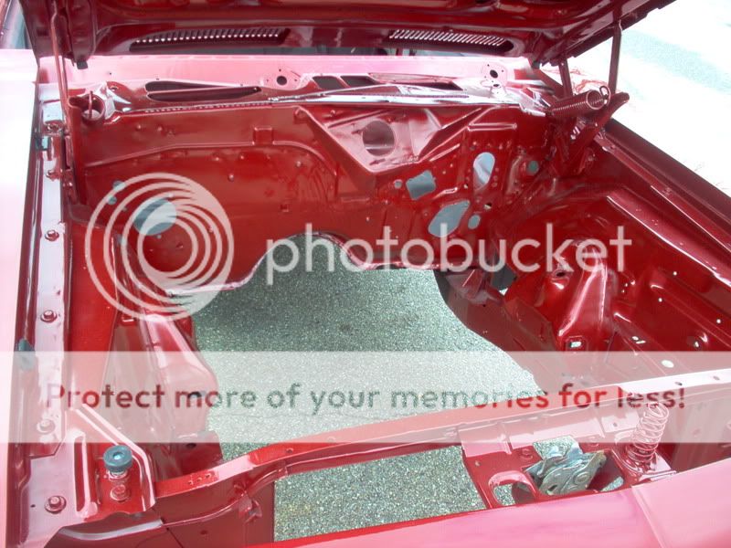

Heres some pictures. The color is 09 Dodge Inferno red.

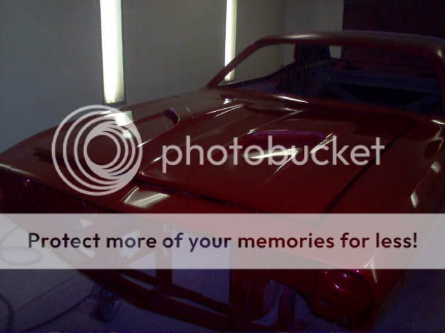

This is just base, no clear yet. We actually pulled all the sheet metal off the front and sprayed the color then bolted it back together. It will get another few coats of color then clear. The car should be painted tonight.

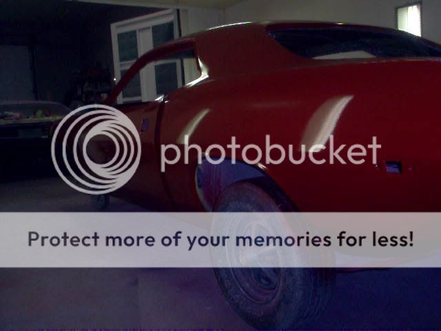

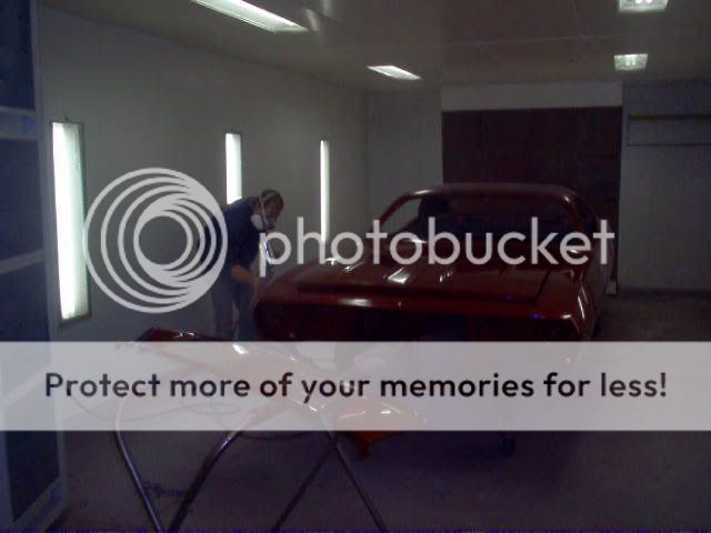

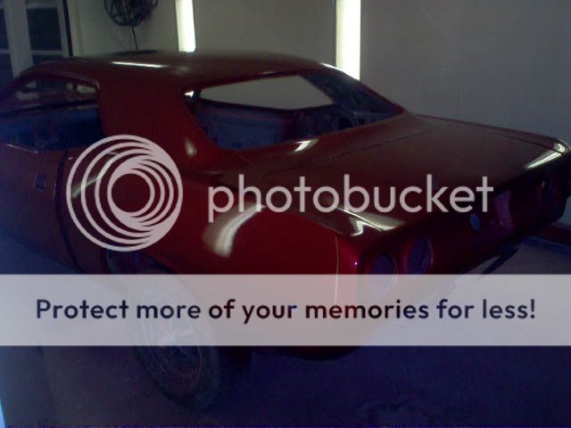

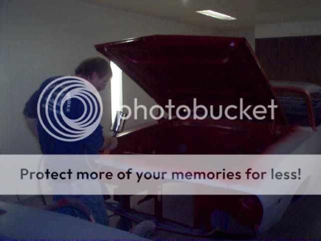

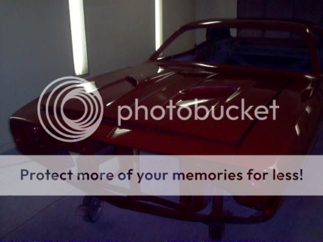

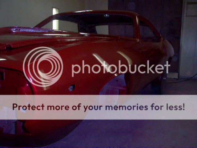

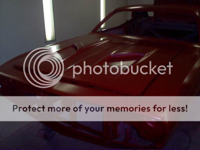

Well it painted, I left the shop at 2am and Kevin was laying down the second coat of clear.
Laying down the clear.
The color looks great and best of all the owner seemed real happy with it. Its going to be sharp when its all bolted together.

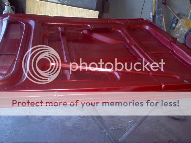

So Adam, what exactly is that color? In the light, it looks really deep........very nice..........
My 74 was in Plum.......Nice color, but yours looks great....can't wait to see it out in the sunlight........:yes:
Yes, Its 09 Dodge inferno Red, Its on the Dark end and is a pearl.
No, we use Sikkens Autobase and Transtar clears.

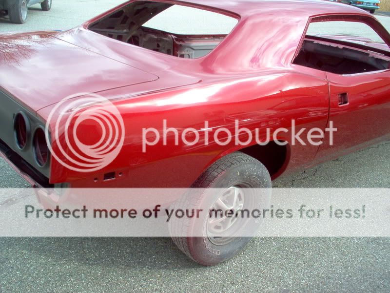

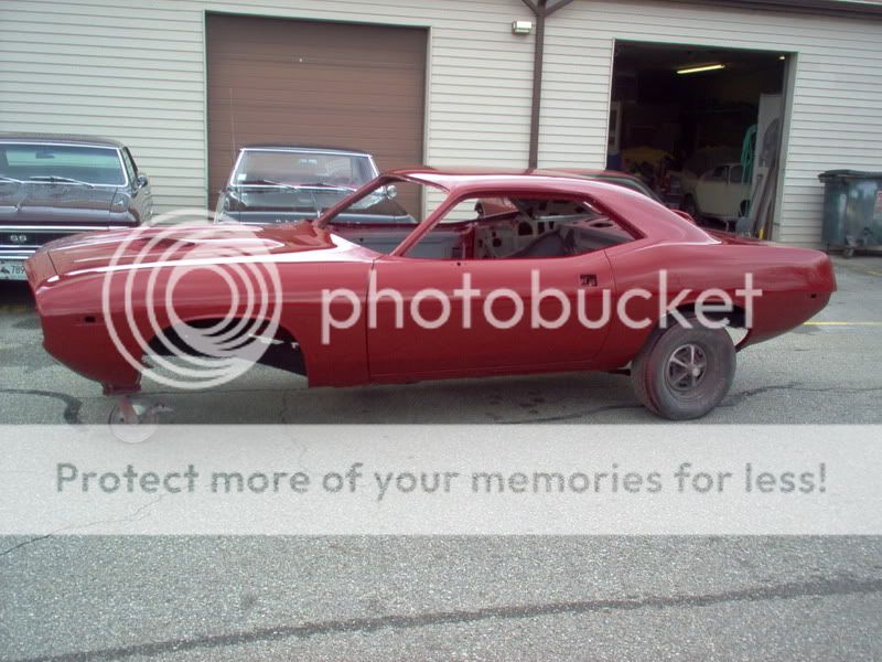

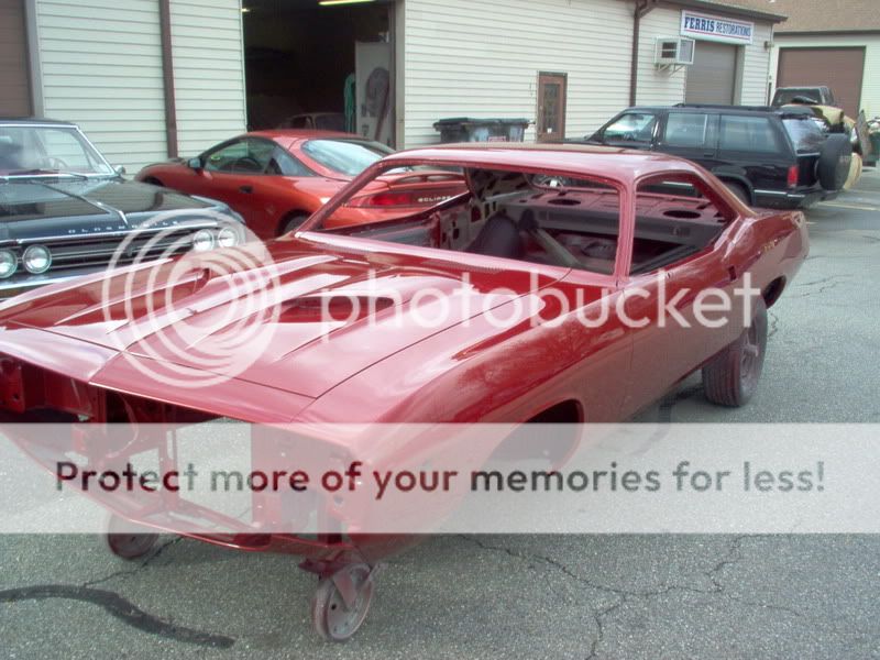

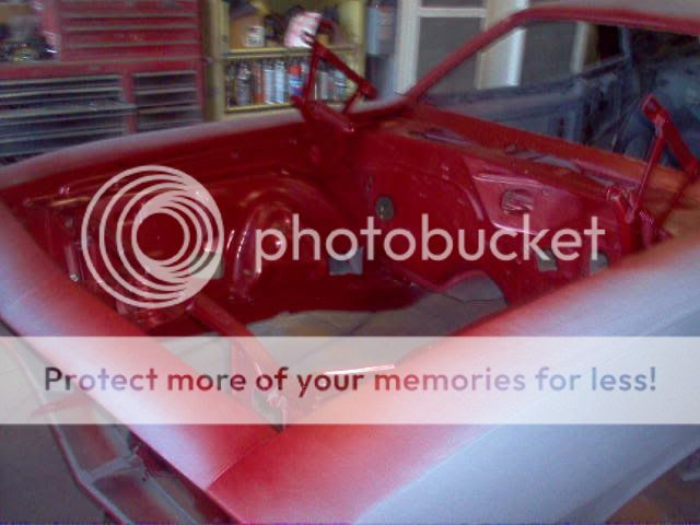

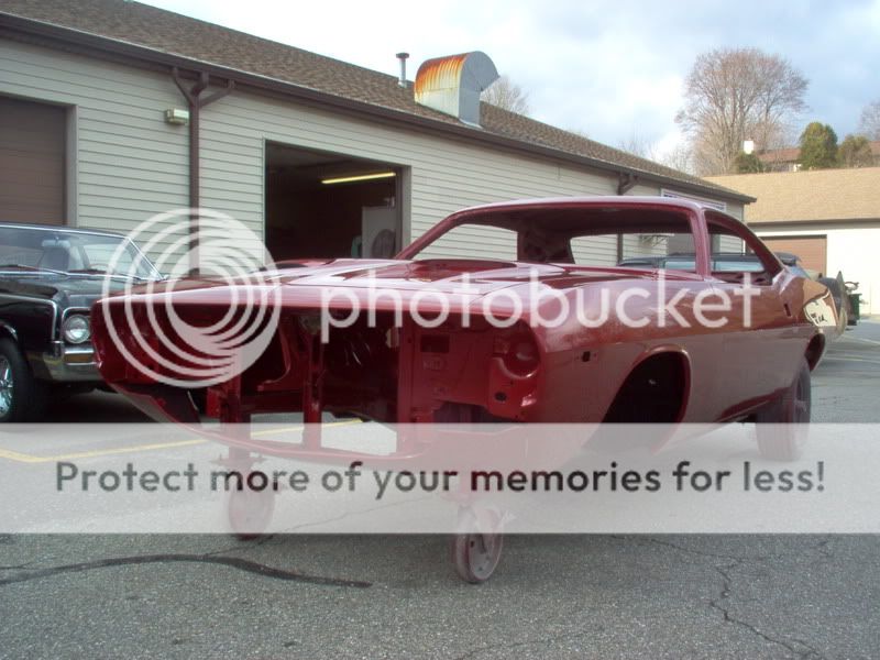

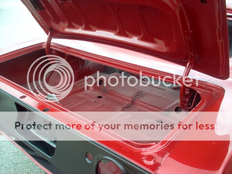

Final pictures, All buffed out and ready to go home.
Yes it will. Its getting some Magnum 500 rims and a black 74 Cuda stripe that will brake it up nicely.
