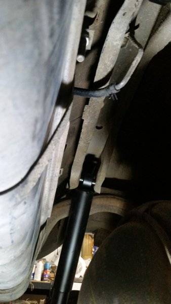

I've got a '74 Charger- I'll snap a pic of the assembly if you like? Not sure how molested mine is/was prior to it coming into my possession but if it helps? Give me a day or two

On my 74 Charger
