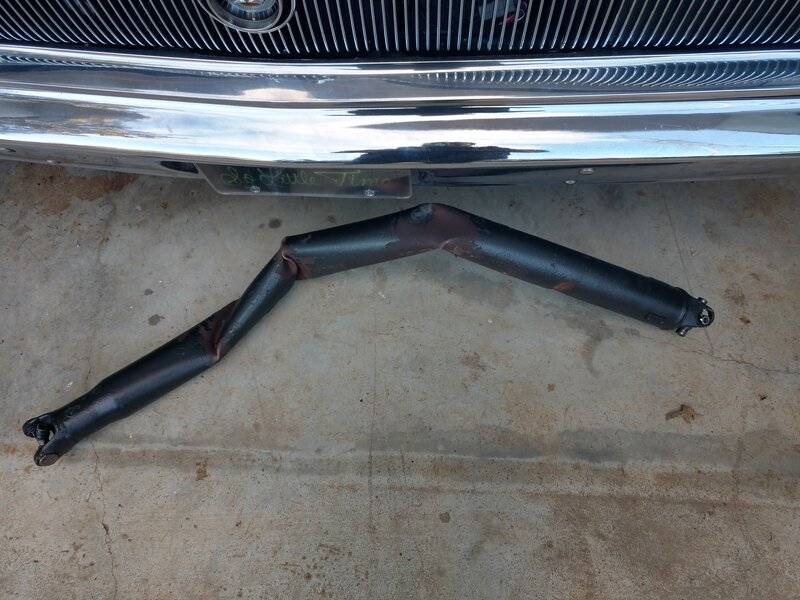

I twisted the driveshaft out of my 66 Charger while on the dyno (u-Joint failure)

Crazy. I still run the bone stock original shaft in my 67, with the little joints. 1000s of passes, some juiced into the 10s but normally mid elevens . 20 some years. 0 failure rate. But yours isn't stock, by the looks of it.
That had to make some noise.
