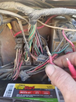

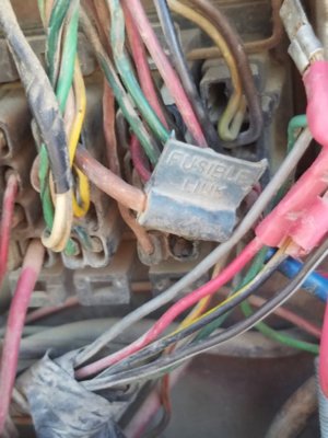

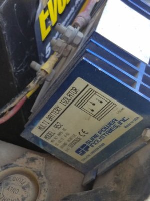

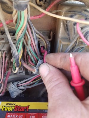

Okay, so thought pictures would explain better if needed. Found the visible link coming from the pos term tri the cluster f*^#! At the bulkhead connection mess.it was showing 12.5 before and after the link so I'm guessing that's okay. Second picture I'm holding a lead that is also coming from the pos term but where it slides into which open slot im not quite sure. The third picture shows which slot I believe it to be from which so far has had no effect whatsoever with key in any position. I also want to add that the power brake controller for the trailer,mounted on the dash in cab is also receiving power. Along with hazards and aux radiator fan. The last picture shows a multiple battery isolator, pretty self explanatory except for the fact Iwas not aware of having a second battery or house battery on board. Anyone know where the house batterywas kept on these sportsman if they indeed were? Also I know o need to trace the lines of power to see where I'm not getting it. If someone would and could point me to the correct order of testing that would be great. I mean I may be able to follow the wires but I'm not always sure of where they end up at or what it is called.

do you have power at the firewall side bulkhead connector? thick red wire ? make sure the fusible link is good. it can be broken but not visible. do you have power at the starter relay? can you jump the starter with a screwdriver at the relay?
you need to make sure you have power into the cabin on the backside of the bulkhead. disconnect the bulkhead connectors and check for power. those corrode over time and there is actually a bypass diagram .if your new battery was going dead, the voltage regulator or the alternator were not doing their job. it should be putting out 13.8 to 14.2 volts when running at the battery. I really wish I could help more but I'm not there. I have arced stuff to but I've never burned anything up . make sure your positive cable isn't corroded. any bad positive connection will disrupt power inside. grounds are everything here. ECU, VR, starter relay are all grounded to the body and rely on metal to metal contact with the body. the fusible link supplies power to the inside , there is also a thick black wire that is hot and should be live . the starter relay acts as a junction.
I missed where you said you have power on both sides of the link. that is the main lead into the cabin. you need to check for power inside the cabin
Want to say thank you to each and every one of you. There was no power going through the firewall. I took off each connector and cleaned all contacts. Voila! Fired right up and running. So thankful and cant wait to hit the road I a couple days. When I have some more time I am gonna post in a carbeurator forum an issue with leaking gas from around the bottom of the carb passenger side where it makes to block but until then. No wonder I was getting such poor mileage! Lol
