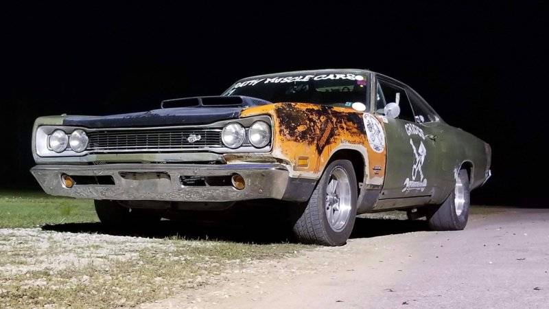

My Super Bee is sniffing the 7s having ran 8.10 on three occasions. Its a 915 headed 383, 2500stall, 3.55 gears and 295 dragradials. Im changing the converter now to a 3500 and expect to cross the 7 second threshold. My friends and I are getting together Oct 19th for a little shindig in Alabama called #MoparVsBrandXstreetcarShowdown, several 440 powered B-bodies have already RSVPed. I just want to make sure my 383 can run atleast mid pack against them all! What Motor/Heads/Converter/Gear/Tire set up has gotten your street car B-bodies in the 7s??? Also open invite to you all to come join us!

Jake's drag strip in Danville, AL. Your "rat bee" looks cool and it looks like y'all are going to have fun! Good luck!
Pretty respectable running 383 street car. Don't go cheap on the converter. Some will suck a bunch of power. Keep an eye on your trap speed.

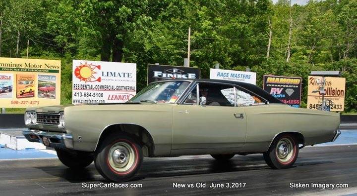

My big sled has run as quick as 7.11, and is as street friendly as any mild musclecar. It’s a basic 451 combo; dual plane intake, flat tappet cam, full stock interior, runs on pump gas. Weighs in at 3850 with me in it. The most “strip” aspect of the car is the fact that it runs a spool (broke a couple of 8-3/4 sure grip units, so......) The only time you notice it is in tight parking lots. Not the fastest street car in town, but it’s legit.

What heads, converter, gear???
How big of an issue is it with the spool???
Heads are Modern prepped Source Stealths, converter is a 9-1/2” Lupo Dynamic custom built for the combo, gears are 4.10’s with a 28” tire
The spool really isn’t an issue to me. You can tell it’s back there if you’re in a parking lot, but it really is just a reminder that you’re driving a bad-*** hotrod, so It’s practically a bonus.

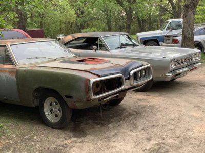

This thing goes 7.60’s
As far as the build, it’s sll stock parts.

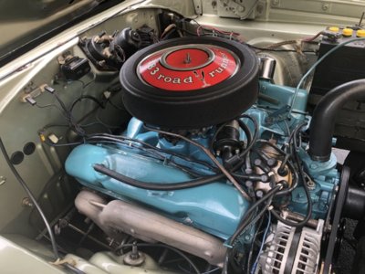

so far 7.07 one easy pass, 512 low deck, street car 4050lbs A/C, overdrive.3.54 gear, 68 Charger drive it anywhere
