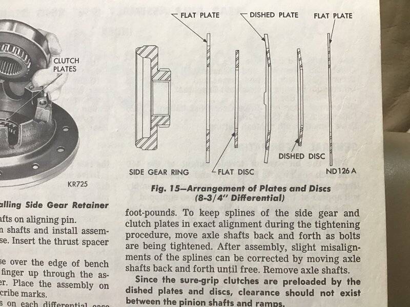

The service manual shows how the plates should be stacked, follow that so it’s working right. There are large and small, flat and dished, thin and thick plates in there.
