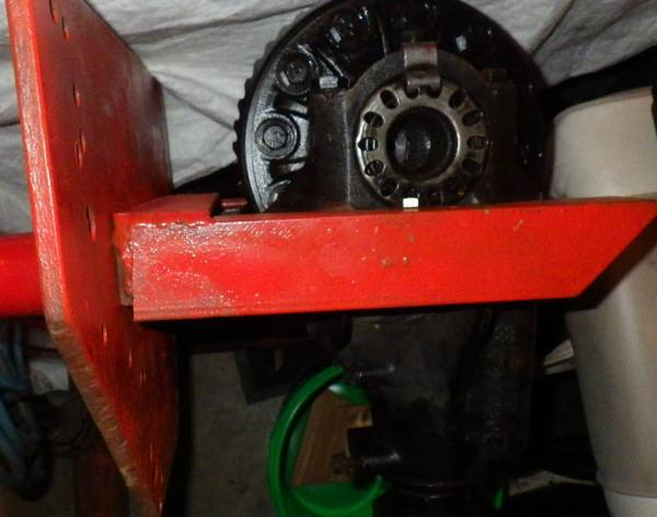

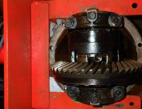

3 pieces of angle welded together and 4 bolts/nuts worked for me...…..
I was just thinking that would be a piece of cake to make !!
IF you have a engine stand just bolt a couple L brackets to it where the adjustable arms go and then bolt to the differential.
You can also use two of the adjustable arms and bolt them to where pinion snubber goes.
