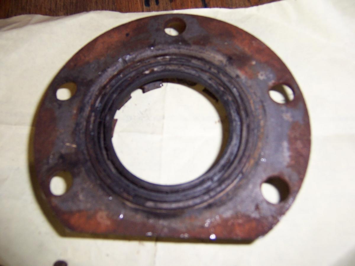

Hey folks;need an answer to "what is this piece?" It came off the axle shaft-one of them-that were getting new bearings installed on. The problem is the seal(can't find a listing for one-though I found a PDF file that may help) and the threaded sleeve arrangement that either holds the seal in or is just for the seal to butt up against. What I need is a diagram/schematic showing the breakdown of the axle flange area so I know whether or not I need to take it apart to replace the seal. This is supposedly a 1965 housing,and the axles were in it,so I'm PRE-suming(as opposed to ***-uming) that they are '65 units as well.

That's the adjuster. Goes on the passenger's side axle and is how you adjust the end play. Should be a little "hook" that goes under one of the bolts and "locks" the ring in place.
69 Runner;thanks! Now I need to find some seals;the ones I need(outer axle seals) are no longer available-at least through my local auto parts store. I also need to find an online article on setting the endplay.
For the outer seal try National or Timken #8704S. The inner seal (goes inside axle housing ends) is 8695S. Both are readily available.

Adjust these bearings by tightening the adjuster in until there is no more endplay in the axle shaft (Rotate axles while tightening to seat bearings). After you do this, loosen adjuster 1 or 2 notches to achieve an end play of 0.008" - 0.015".
