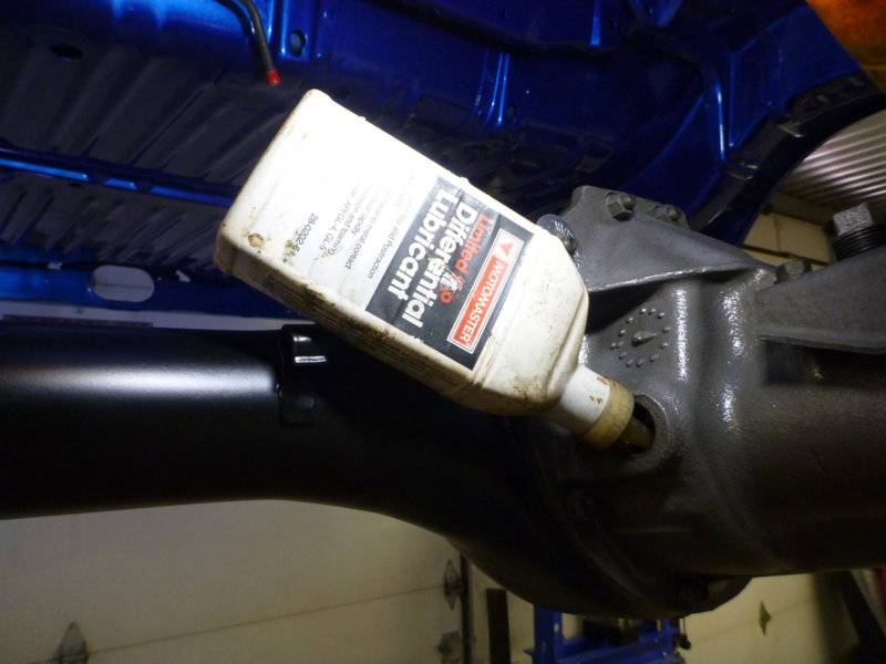

doc diff told me on my 8 3/4 power lock to use the additive he sells witch is motorcraft and conventional gear lube.

Id use the 80/90 conventional with the Motorcraft friction modifier. You can buy it at your local Ford dealer.
If Auburn won't warranty the limited slip with any other additive but theirs, get it from them.

Q23. What kind of oil should be used with an Auburn limited-slip differential/ Auburn Select-A-Loc differential?
A23. Non-synthetic 80w90 GL-5 oil treated with Auburn Gear friction additive, part #504102 (also known as a friction modifier). See Catalog page 32. Three (3) ounces of additive will treat one quart of oil. GM or Ford limited-slip additive may be used. We do not recommend synthetic oil. Auburn limited-slip additive is packed in every box with the differential.
