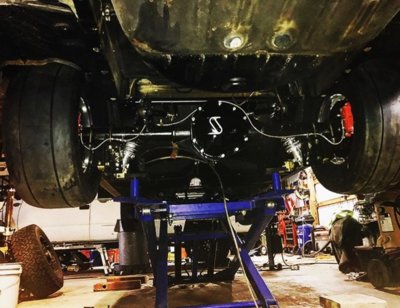

You don't need to spend $2800 on a Dana!
I cut the full floating ends off a truck axle, had 8 3/4 ends welded on and installed Dr. Diff axles and a spool with the stock 3.54 gear.
I have well under $1k in mine.
