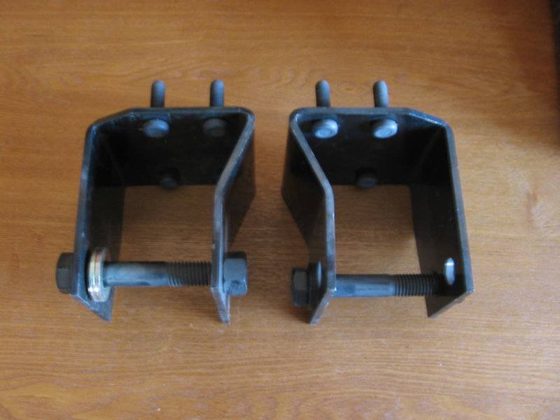

Are these something you can use ?
My 74 RR did not have room for the offset front hangers. The OE hanger location was too close to the frame rail. Mopar user to sell an offset rear shackle that might work in your case. Another thing to keep in mind is that you will need a shorter driveshaft as the 8 3/4 is 'longer' (front-back) than the 8 1/4.
Darter6,
Do you know what the offset is on those hangers? It doesn't look like they are offset enough to cover the approximate 1.8" the leaf needs to move to make the axle work.
I'll measure 'um and get back to you.
The Dr. Diff kit typically offsets the springs inward 1".
Not as much as 1.8".
Looks like 3/4'' per side for the ones I got.I took some photos and they were too light,too dark or blurry.I'll try to post the best a little later.
Darter6,
Thanks, but I don't think those will work. Building custom hangers is what I'm going to have to do.
No problem. I watch for things guys are looking for. Sometimes I have the stuff collecting dust on my shelf.(and I got lots of it) It's easier than posting items one at a time.

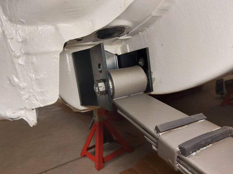

The mounts that Darter6 posted have a 1 1/4" offset.
I have the same ones on my 71 B-body.
Those mounts are to be used when you have super stock leaf springs for the car.
They cannot be use with regular leaf springs.....I just found this out the hard way.

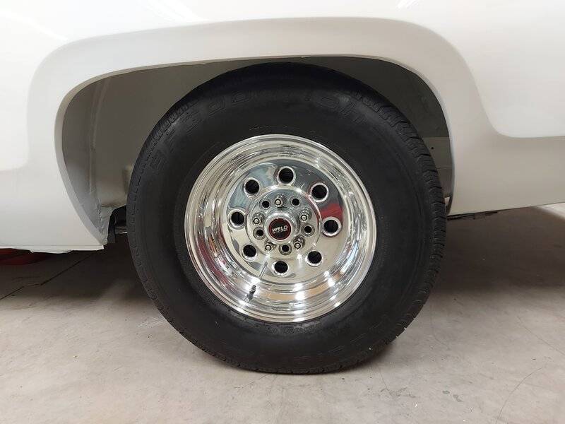

Using those mounts with regular leaf springs moves the diff rearward and it does not sit centered in the wheel well.
See what I mean?
The original mounts I took off my car were homemade by someone else......now they are going back on my car...
