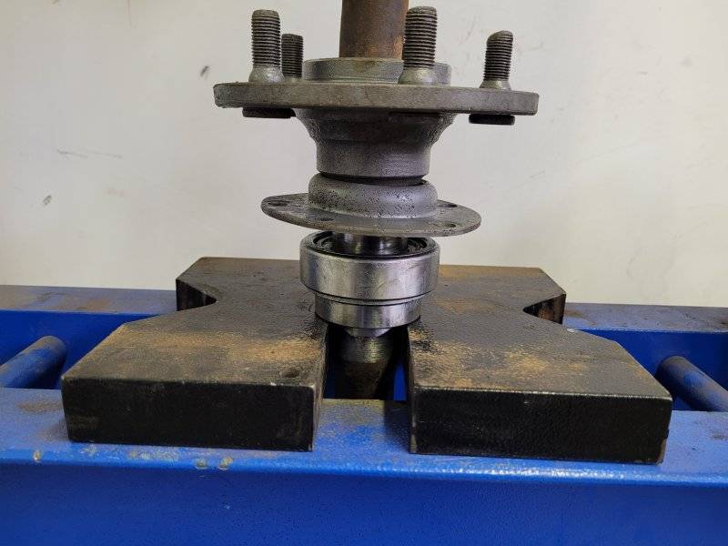

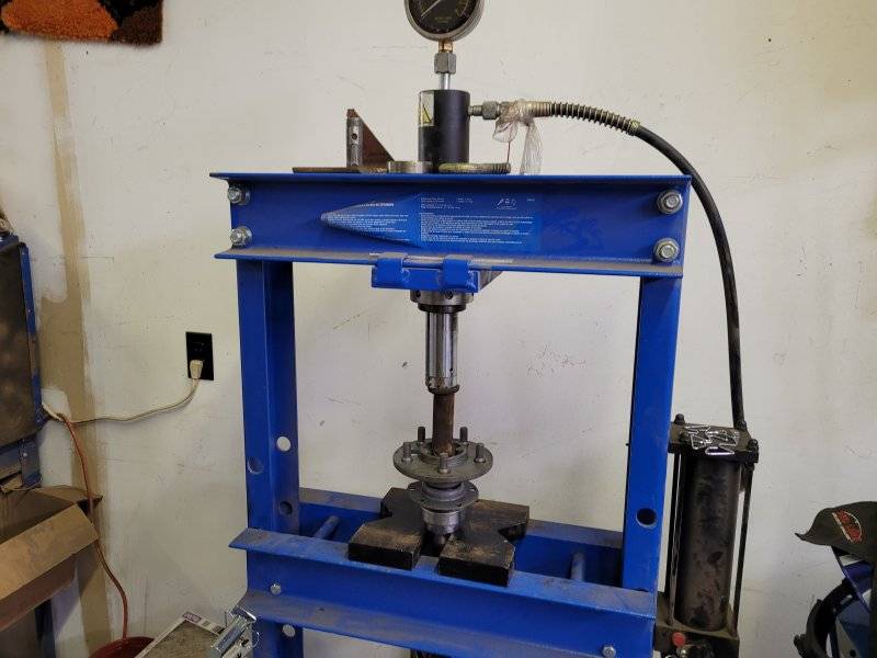

You're removing and pressing back on bearings either way you look at it to change that seal. Do it right, do it once...to last for the rest of your lifetime. Put Timkens back on..

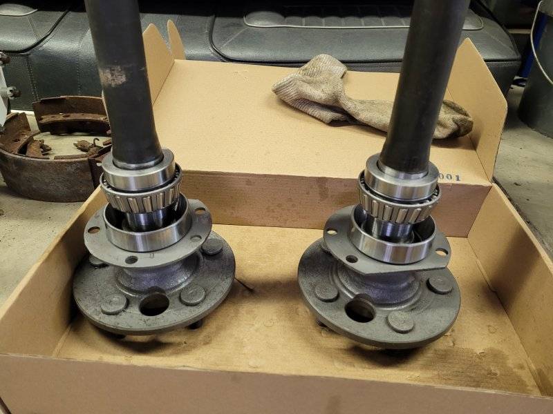

The Chrysler engineered Timken tapered rollers are what the factory used. They have worked in millions of cars for millions of miles. NO ONE can say they don't work properly. Now, the question always comes up about switching to the Green Bearings, and if anyone has had problems. Some have had issues, some have not... Always the same possibility of problems. Why take the chance???
Just my opinion, but I know which way I will always go.

Thinking it over, went with OEM style, and ordered the Timken set from Cass,@ Dr Diff. My Son has a press, so soon to be repaired. May change out the diff to a 3:55 I've had for a while since it's apart...
