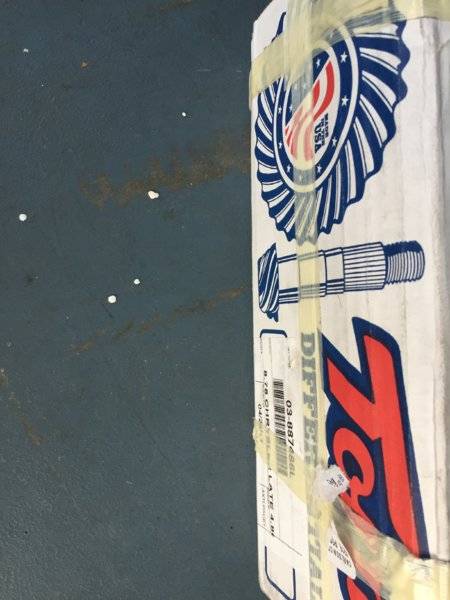

Got gears today, from US Gear !

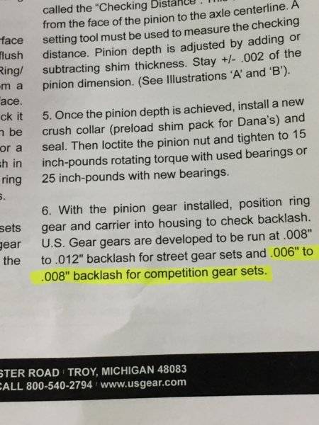

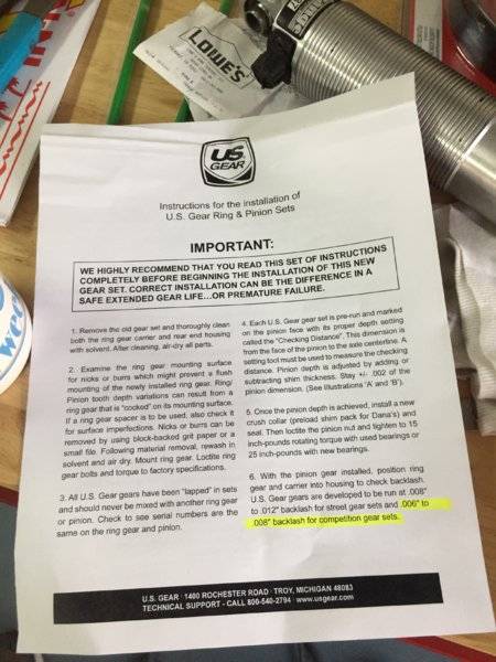

Moparcrazy, where did you get the idea to run 0 BL? Everything has to have some clearance to live. And that spec sheet is just the opposite from the info I have for setting BL....unless there's new thinking or new materials that are being used to manufacture gears? I never have given much if any extra BL for drag racing but have gone with .010-.012 for dirt and oval track stuff with .008 being the number I shoot at for the street. But one thing the remains the same is to check BL in at least 3 different positions. It's very rare that you will find a carrier that has perfect runout and that goes the same for the ring gear and they can stack up against you. Once I rotated the ring on the carrier to see if things would improve and it did. Having .007 in one spot and .012 in another didn't make much sense to me so I checked the runout on the mounting face of the carrier and it was out .005 and rotating the ring gave an acceptable reading checking in 4 positions....
