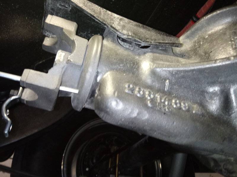

I'm trying to put my drive shaft in and keep running into problems. All I have left to figure out is how to secure the straps that hold the rear u joint (7260/7290= napa#347) to the rear end yoke. Do I need some u bolt type retainers? The holes in the yoke do not appear to be threaded, but they seem kinda small fo a u type. Has someone drilled the threads out for me? I bought this chunk used and recently noticed it has a problem. The yoke is stuck, I tried to impact the nut off without success. You can see where some idiot beat on it with a hammer trying to get it loose. So if I can't come up with something to hold the straps on or put u bolts in I'm screwed. Anyone put bolts all the way thru with nuts on the back? Any schooling is appreciated.
It should have 1/4-28 threads AKA 1/4" fine thread... That's a 489 case so it has a crush sleeve... You don't want to loosen the pinion nut unless you know the idiosyncrasies of working on a 489 case..
If somebody drilled out threads run 1/4-28 grade bolts and nuts with lock washers. If fastenal is in your area they sell grade 8 nylon lock bolts. U bolts can be over tightened and distort cup causing premature wear/failure. MO

I would pull the center section completely apart to see what you really have going on. That nut could very well be stripped or rusted on there. To get that nut off " heat always works" Get the NUT red hot then use your impact . The yoke should then tap off with a BRASS hammer. If not use a puller.
Back to using that yoke, I've done what Fran said above. Drill thru with nut on the back.On some yokes the back is not flat so you may have to finish grind it flat. I went thru this on a Jeep that had the threads messed up.
