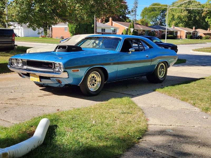

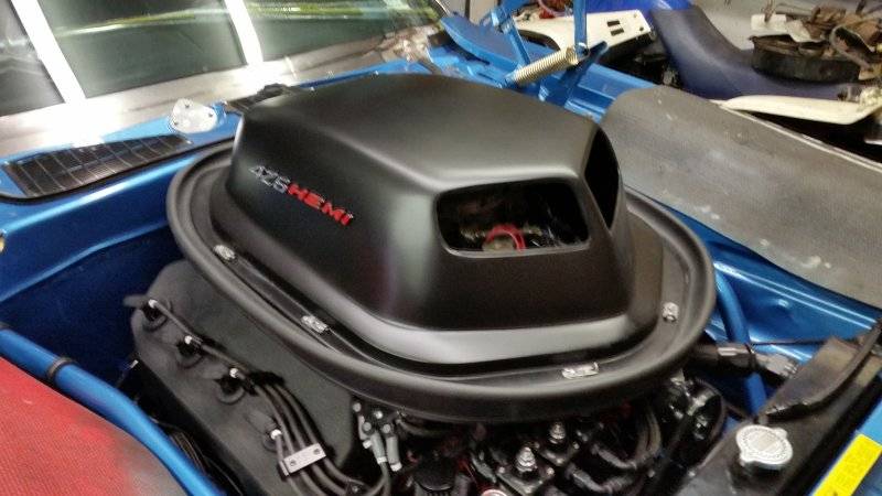

Nope, I honestly don't care that much. I modified my original A66 340 car to build it my way but still stayed old school now with a 528" Hemi with two kits. As they say it's one car, one can build them however they want.
