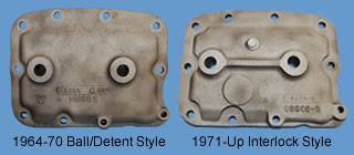

were on the passenger side will I find the 3 inch pad with numbers? I think it is a 71 do to the side cover.
thanks Dave I only have 1 mounting pad for shifter.
It is a pretty obvious pad, but pre 68 manual transmissions did not have them. You can't go by the side cover that is on there now. You can't go by the tailshaft housing that is on there now either, but one shifter pad is pre 70, more or less.

casting numbers 0-86581 n tail c86707 27 inches long only 1 shifter mount. side cover looks to be 71 dont know how it could work.
