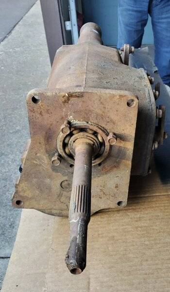

    First post here, but I have an inquiry. I’d like to put an 833 in my ‘72 Charger at some point down the line, so I bought one trans that shifts into all gears and spins freely but it has the A body tailshaft. In that same deal, I got another one with the B body tailshaft for really cheap because it either won’t shift or won’t spin freely, thinking I could swap the tailshafts. I’m new and have never messed with transmissions, so am looking for confirmation that this is possible. Also, they both have the ball and trunnion setup. My driveshaft should be slip yolk. How do I overcome that? I’ve heard about conversions, but don’t fully understand. Hope you all believe in the philosophy of “no stupid questions.”

    You’d need to change the output shaft, that’s a tear down of both transmissions. But yes, doing this will give you the trans you need for your car.

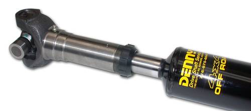

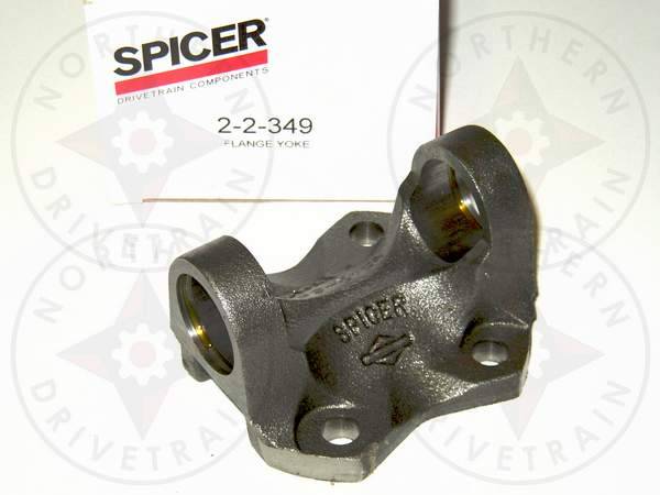

          Depends what your purpose is. Ball and trunion parts may be hard to find and they are also not the strongest set up. If you go that route you can convert to the slip yoke setup like a 4x4 front driveshaft.
          If you have to have a new driveshaft made anyway going to the slip yoke then might as well make a new driveshaft that uses the drive flange on the ball and trunion. Spicer makes the adapter I believe. Any driveline shop should be able to make this happen.
          And here it is
          https://www.amazon.com/Spicer-2-2-349-Flange-Yoke/dp/B00GAPJQC2
          Then get the U joint and the slip yoke setup. Your drive shaft will look like this
