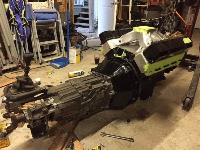

No which is part of the reason I chose it. The TKX was specifically designed to fit older cars. The kit they sell is as I said complete, trans, shift handle (not sure what they have for a 68-70 B body but for a 71 up B its a billet pistol grip), bell housing, cross member, fly wheel, pressure plate, clutch, hyd throw out bearing system with MC and lines, etc. Hell they even give you the trans fluid.
Damn even the fluid . So is it a hydraulic clutch I assume. That would sure be sweet. Did you already get yours installed. Was it pretty straightforward. How much is the kit I'm guessing in the 5k range..

Well the shifter can be placed in a variety of positions along the top of the trans. Part of their pitch is that the trans will basically replace a standard 833 in terms of overall location, fitment and I believe shifter location.

Here is detailed information on TKX shifter positioning. Silver Sport Transmissions makes a B-body kit.
https://moparconnectionmagazine.com/silver-sport-transmissions-tkx-front-shift-kits-add-more-fits/
https://moparconnectionmagazine.com/silver-sport-transmissions-ships-their-first-mopar-b-body-tkx/
Per the article: "While it’s confirmed to be a no-cut fit for E-bodies, B-body tunnels will require a bit of massaging to gain the TKX’s extra gear."
Now I just wonder what "a bit of massaging" means? I can't help but be cautious and even a bit cynical about that statement. When I installed my Gear Vendors overdrive into my 727 equipped 73 Road Runner, they said I had to "dimple" the tunnel. Well, :bs_flag:, I had to beat the living crap out of it to get enough room for the GV unit.
I'm super curious to see how this fits in a B body manual car with no console. It seems like a super nice transmission.
I will be installing a TKX into a 71 Charger and into a 70 RR so I will get some first hand information on this subject. It will be awhile before I do either but I will post what I find/do here someplace. The RR installation is going to be a bit different bc the car's owner wants the shifter back in basically the E body location so we will see how that goes.
