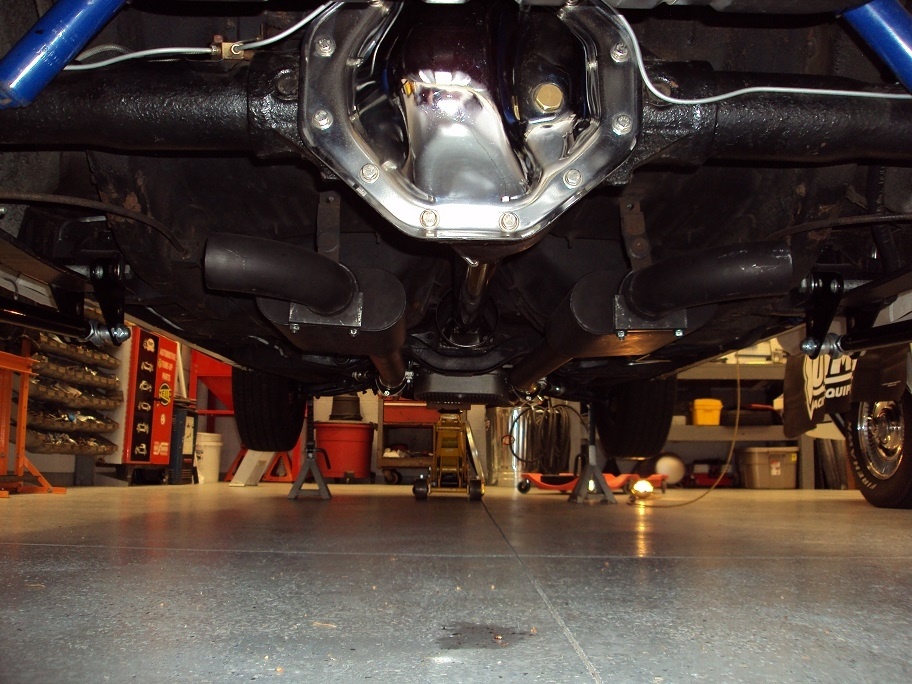

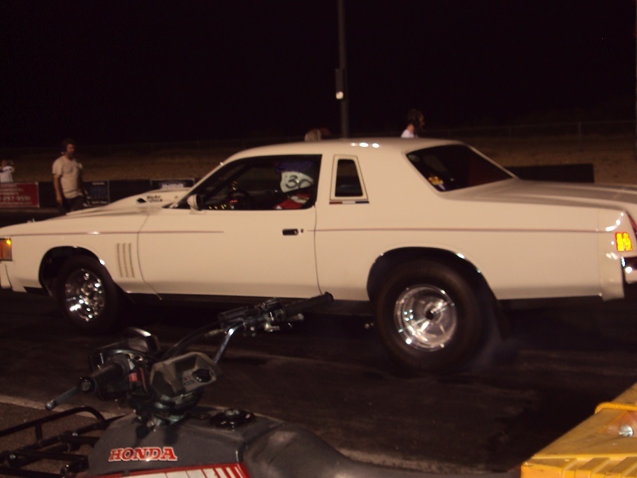

I have been running a 9 1/4 for a long time in a mid 10 second car. Next strongest thing to a dana 60. You will never break it.
Have you beefed it up any
Nope. There is nothing you need to do to the housing. I run Yukon gears. The only draw back to that diff is that no one makes a spool for it yet. Many different types of posi units available for it though. Since mine is a race application only, I had my center section ( spiders and side gears) welded up.
That is good info. Thank you very much. Very cool car you have as well. Is that a small block car.

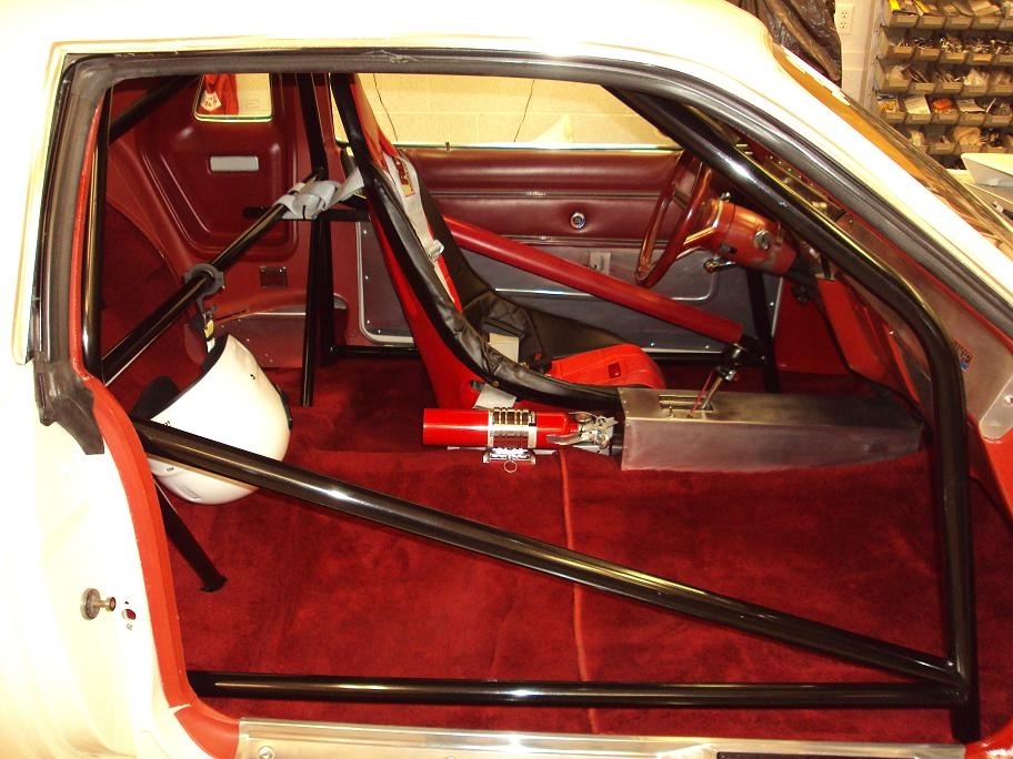

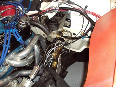

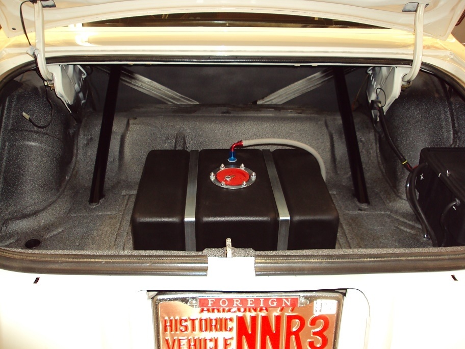

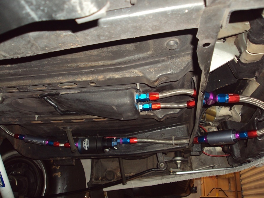

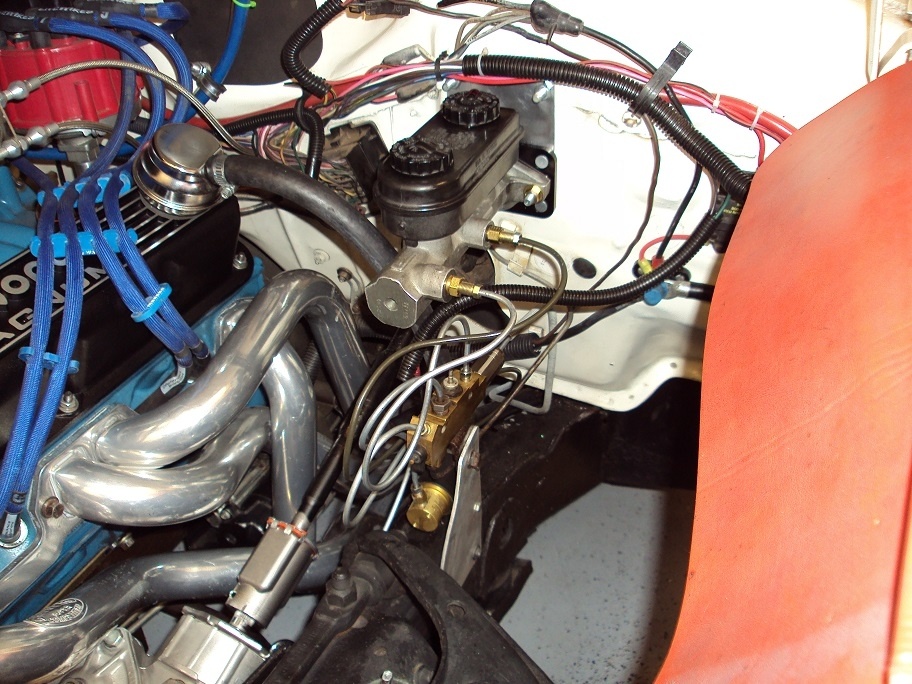

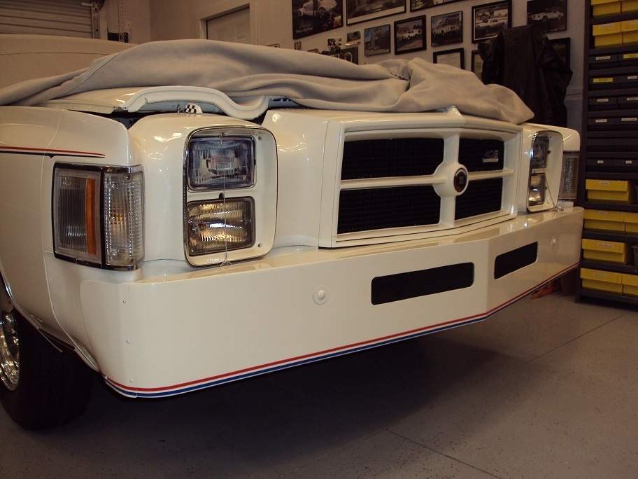

WOW you got it pretty lite. What did you do
Removed most the interior ( seats, counsel, dash, much wiring, all the HVAC, power steering, power brakes, inner fender panels, cruise control and wiper system, fuel tank for a 8 gal fuel cell, and replaced the 50 + lb front bumper with a 7.5 lb frt bumper. Probably dropped 75 lbs off the engine with aluminum heads and intake. Those were the big items I can think of. Car originally weighed 3960.

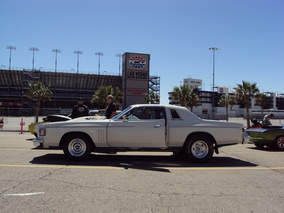

Thanks Bob. Just remember, mine is a race only application. Don't loose sight of what you want to end up with in pursuit of a low ET. Always sacrifices involved if you are looking to have a dual purpose ( race / street ) car.
