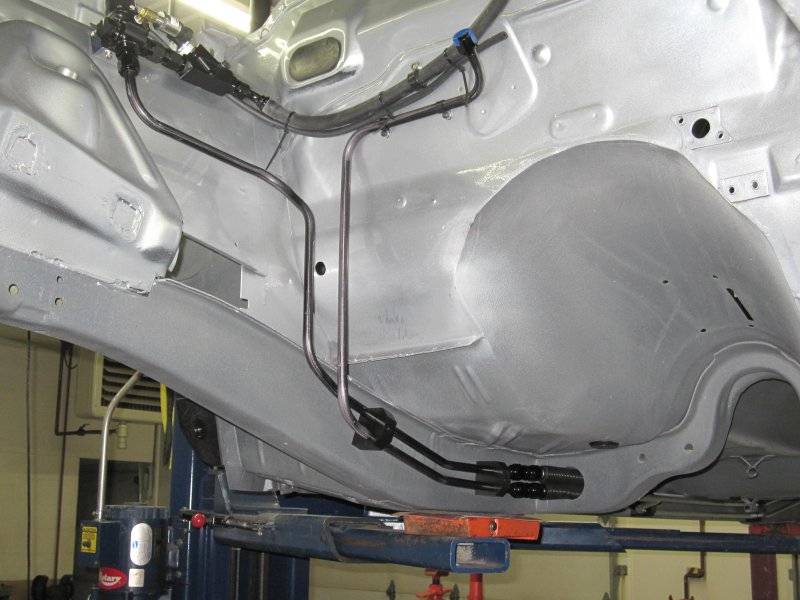

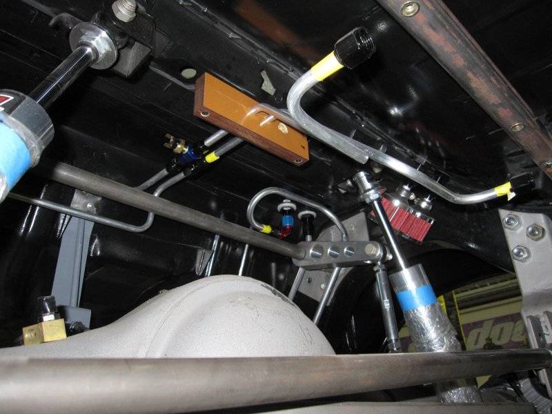

Stock lines are 5/16". You can purchase a set of benders and flaring tool for the cost of store bought lines, which may not fit your car and own them for the rest of your life and still make professional looking coolant lines for your car. I hope you can use this situation as a learning experience and develop skills that will help you with future projects. I have included a couple of pics of my fabrications.
