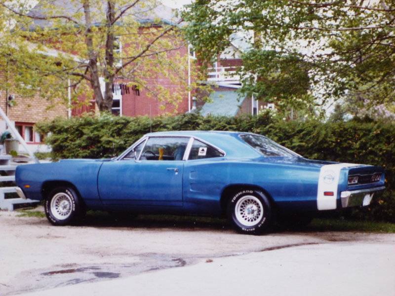

If you're worried about tires giving up on you then you'd better park that car and grab a blanket PB ! Here's my car when I grabbed it from my Mother's after Dad died in 1986. Those old CTC Tornado bias ply tires saw 150+ on MANY a Friday night in the early '80's with my 4 gear and 2.94's.. pedal mashed to the floor for MILES.
