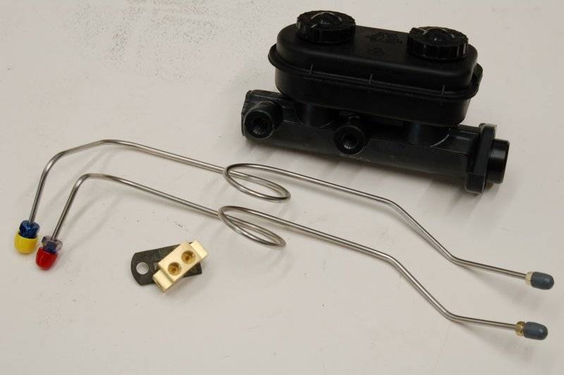

      Doctor Diff can provide a master cylinder. I also recommend the conversion kit from Inline Tube. The Inline Tube kit has the two master cylinder lines as well as a new distribution block that bolts to the frame rail.

            the brake line with the blue fitting will not bolt up to that style MC. it will bolt up to the GM style mc I just ran into that problem .

                  You must be thinking of something else. The kit I bought from Inline Tube bolts on to a Mopar master cylinder just fine.

                      nope. bought online also. WOULD NOT my Mopar M/C
