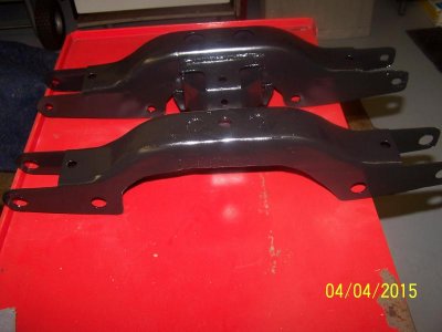

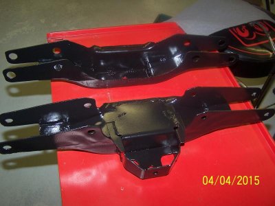

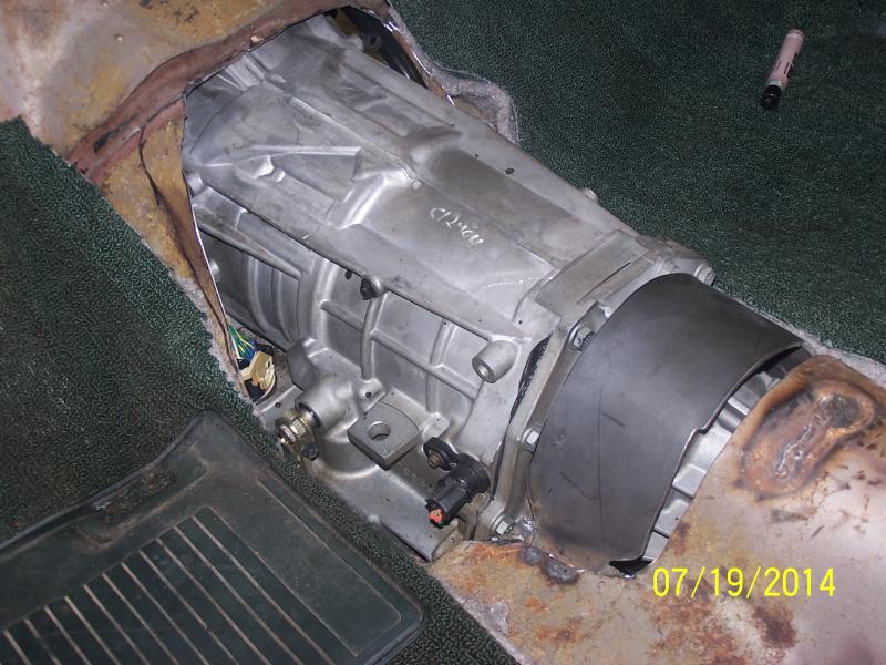

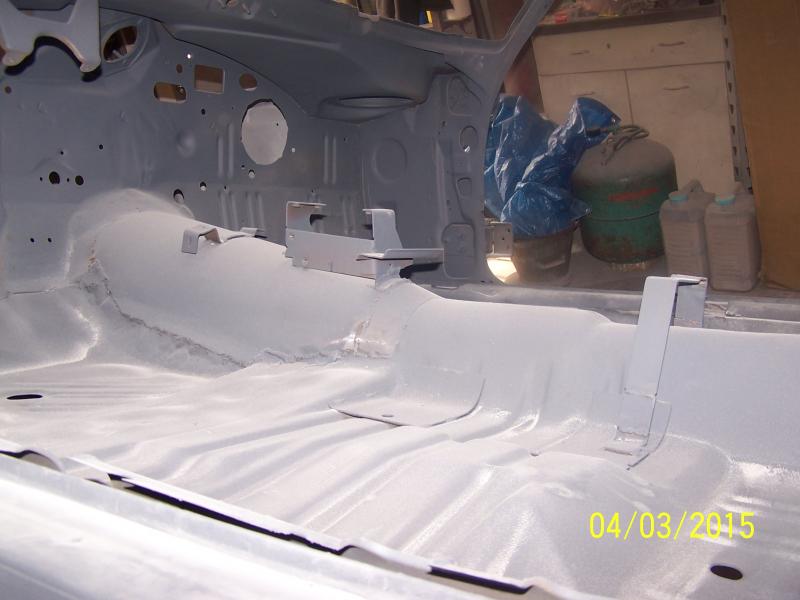

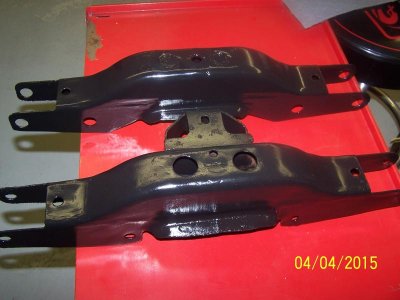

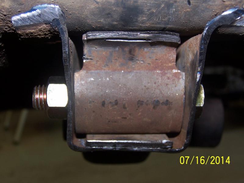

Here are some pics of what I did with my tunnel. As you can see, it was a bit more than a couple whacks with a ball pean hammer. A good tin bender would have made it look nicer but it will be covered up for the most part. The 1st pic shows what I cut out of the TB cross member. 2nd pic shows the stiffener added back in for the relocated cross member bolt.
I don't have any measurements but you can see my tunnel is raised up 1 1/2" and my console will be 1 1/2" higher because of it. I wanted the tunnel up to make room for the shift cable to be able to fit above the transmission. I don't have all the t's crossed or i's dotted but it is starting to come around. The last few pics show what I did with the Transmission cross member. I put in a unmolested cross member to show the surgery I did to make it work. Hope it helps. I can get some measurements of whatever you would like. On another note, I have the 6.1 exhaust manifolds that will fit your 5.7 if you want to cut them up to try to make them work. I won't be needing them.

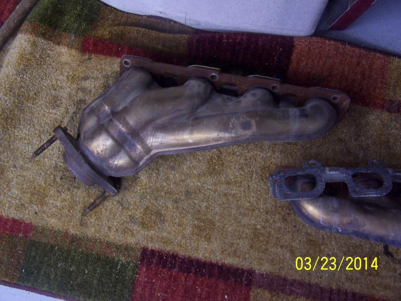

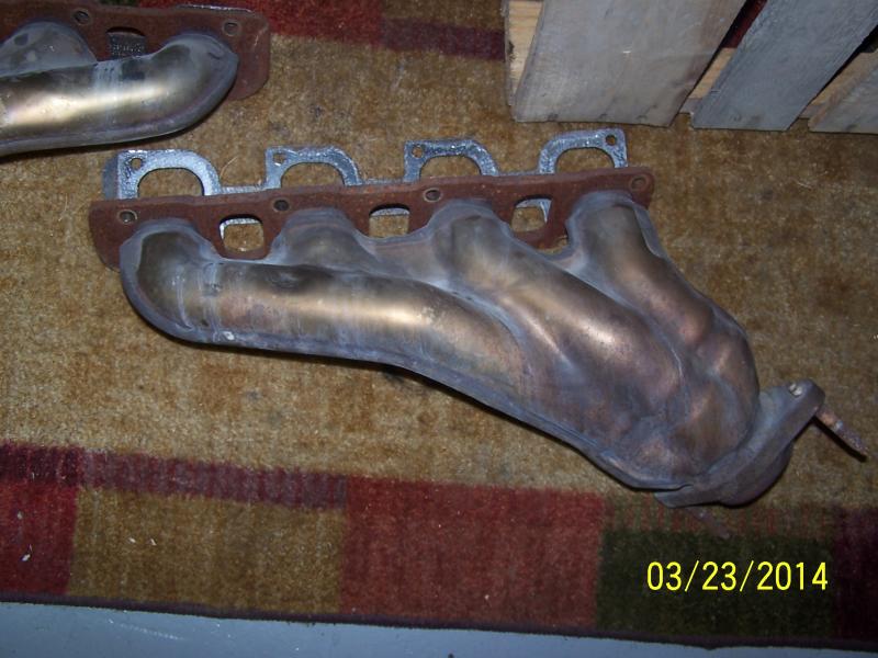

Here are a couple pics of the exhaust manifolds. My engine came out of an 06 Charger SRT8 so that is what these manifolds are. The ends would need to be cut off and turned down to enable them to work on a B body. As they are, they are aimed at the firewall and would be almost impossible to install a head pipe to them. I didn't want the headache so went with TTI's headers. 100_6186.jpg100_6187.jpg
From the info I have been exposed to, none of the stock exhaust manifolds will work with our B bodies without re working the outlet because they do not turn down enough to enable a head pipe to be hooked up to them. I am working on a 6.1 with 545RFE transmission in my 68 Charger. I bought a kit from Bouchillon Performance for my install. You may want to call Randy there as he has had considerable experience with these installations. He provided me with the oil pan, motor mounts, TTI headers, offset oil filter, and some AC fittings since my car has AC. My AC compressor caused an issue with the TTI left side header needing to be dinged a bit but if you don't have AC, they would fit great. I don't have mine put together yet but I did a mock up and the tunnel needed the most surgery. I raised the tunnel about 1 1/2" and needed to cut out the TB cross member and weld in a new piece to enable the transmission to fit up high enough. If your car does not have AC you can use a fly by wire gas pedal. My car did not have enough room for the fly by wire pedal so I need to use my factory pedal and convert to the fly by wire under the hood. I have a couple of the fly by wire pedals that I tried to make work so if you are interested in one of them, let me know. I bought a computer and harness from Bouchillon also. Don't have any of it installed yet as the body is not back from getting surgery. A couple more things you will need to think about is what you will do for a speedo since the truck 5 speed has an electronic sender. Bouchillion has an adaptor that converts the signal to a cable if you want to use your cable drive speedo. I went with a GPS speedo so don't need to worry about that. Also you will need to install a water temp and oil pressure sender to be able to use your factory gauges.

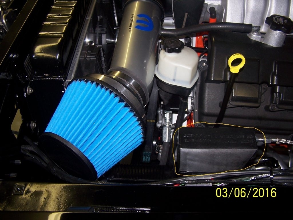

My 68 Charger has the A/C heater box. Way too big under the dash for the fly by wire gas pedal. No room between the heater box and steering column. My fix was to use the stock gas pedal and use the bell crank assembly from an 2004 Ram truck. Here are a couple pics showing the under dash area and the bell crank circled in yellow in the under hood pic. If you don't have air, you should have room for the fly by wire pedal. They are kinda ugly in my opinion but you will have to decide which way to go.
