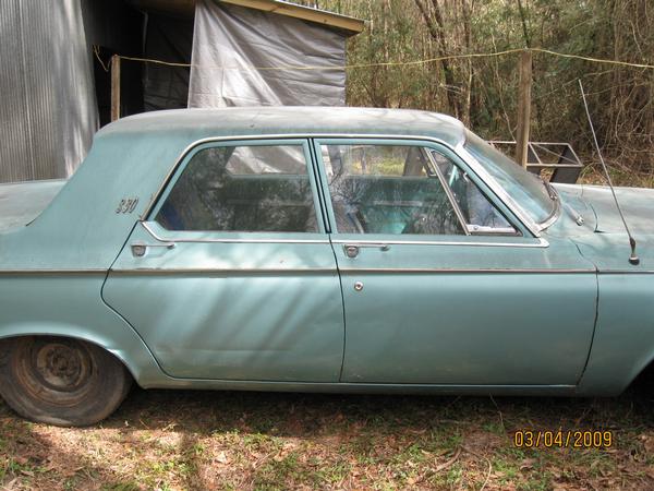

While you are at it pick yourself up a 4 door belvedere and it will make the rearend transformation so much easier. I will tell you why later.

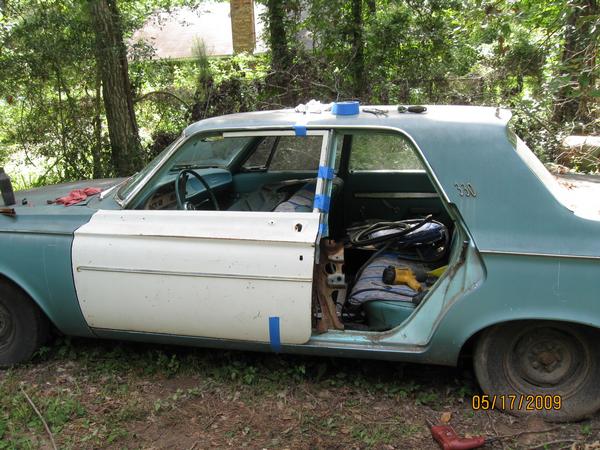

hey mr. howie iam about to alter a fourdoor can inlighten me on the subject any tricks or helpful photos thanks b.taylor
You need a 2 door car and a 4 door car to do the altercation. There is a seam at the lower rear section of both cars. The 4 door is cut at the rear of the truck behind the rear tire and shackles. The front is cut right in front of where the rear seat floor dips down. On the 2 door you will cut the rear frame 15 inches fwd of the shackles and where the floor seam dips down in front of the rear seat. That will give you your 15 inches diff for the awb rear end. You can order 50 inch torsion bars from firm feel. trust me it is easier that way. I looked for an old car with those bars and removed bars from 3 cars and they were too short. Hope this helps out a bit.

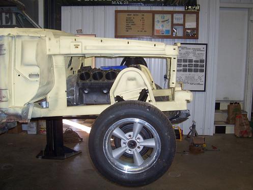

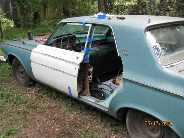

I have yet to alter the rearend. This past season was the front end mod as I have quite a few projects. Here is a shot of the front being altered. Well I was going to upload a shot but don`t know how.
thanks howie i have some 50" torsion bars got um from wildcat wrecking ill upload some pics a soon as its under way

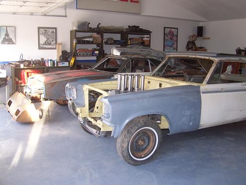

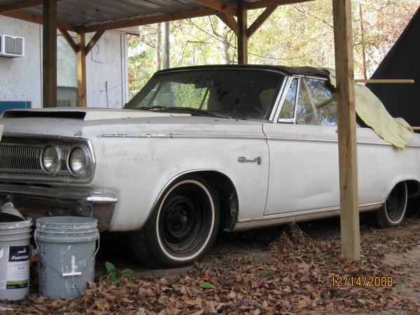

What was the reason for installing post (framed) doors into the 65 coronet hardtops? What it to give a little more torsional rigidity to the body? If I do our 65 hdtp, I wanted to keep the non-frame doors.
It wasn't a weight issue that's for sure because a framed door is heavier. I think it was for rigidity...but poly1963 could be right.
The Plexiglas was fixed in the up position on the factory fiberglass doors..
