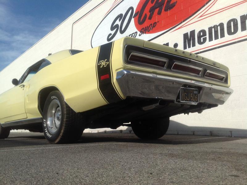

image.jpgSummit. Inserted a leaf each side. Gave about one inch. Just right.

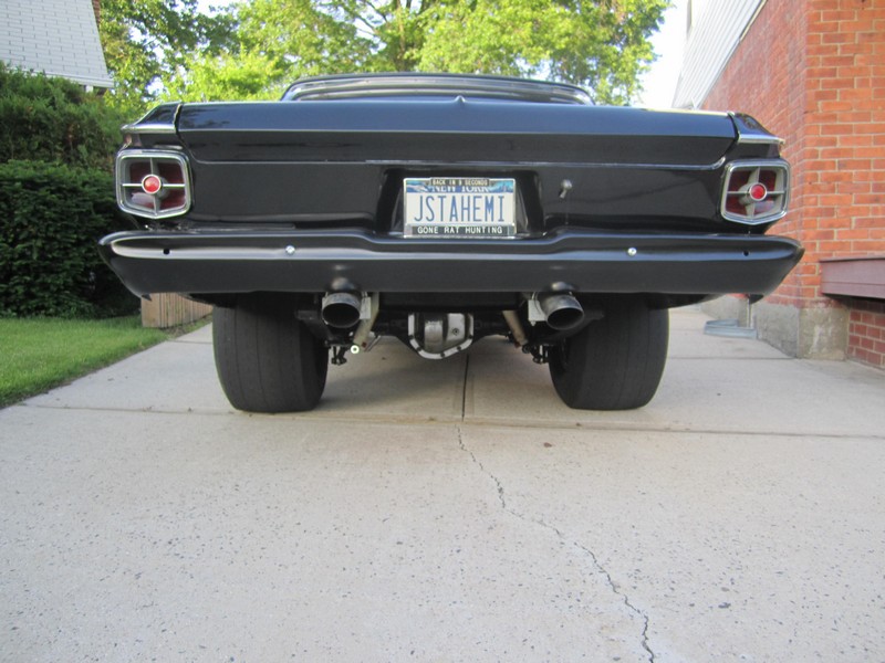

These cars came from the factory flat and Hemi springs will not change that. People order hemi springs put them on and in a short period of time they flatten out to where they should be. Jacking them up was a 60s 70s thing that just hurt weight transfer but if that is the look your after then add a leaf or get them re arched at a spring shop. :VB toast:
I think it has a lot to do with your HP level and the intended driving usage. Stock type parts are fine to about 500 HP.Then the performance springs come into play. I like the calvert system because of the adjustability. It's same with shocks.There comes a time when you need a better shock or better yet,adjustable shocks.
Flat is one thing sagging is another, I was getting a vibration at 75 + and I did all the usual checks until I found my pinion angle was off, I lowered it about 3-4 degrees and no more vibration, the springs are sagging and had rolled the axle. My car is all stock and 45 years has taken its toll, time for new springs to make it sit how it's supposed to.
Btw re arching the springs doesn't last.
Hemi-itis, that car looks bad *** from any angle! :icon_thumleft:
I got mine re arched in 09 and its still to high for my liking.
