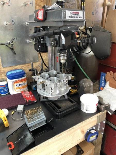

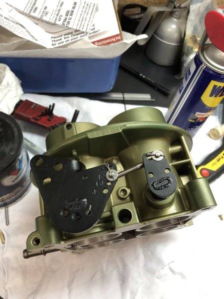

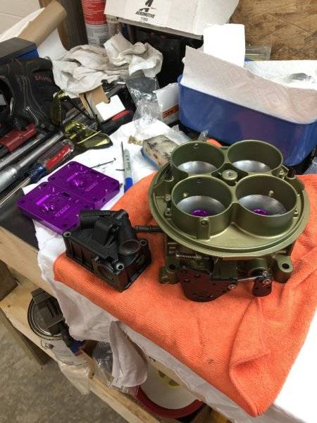

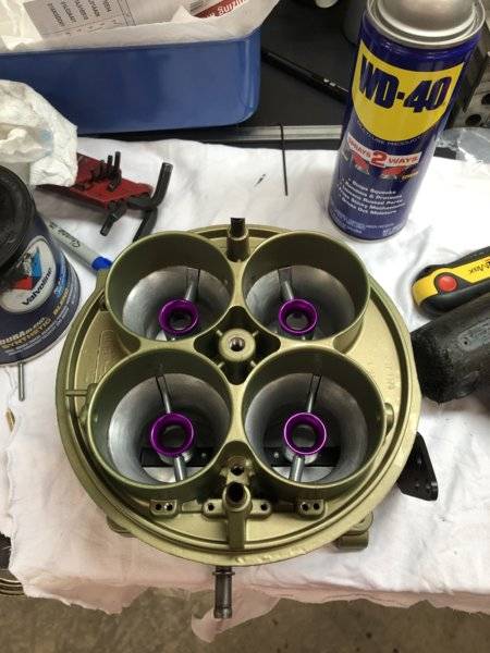

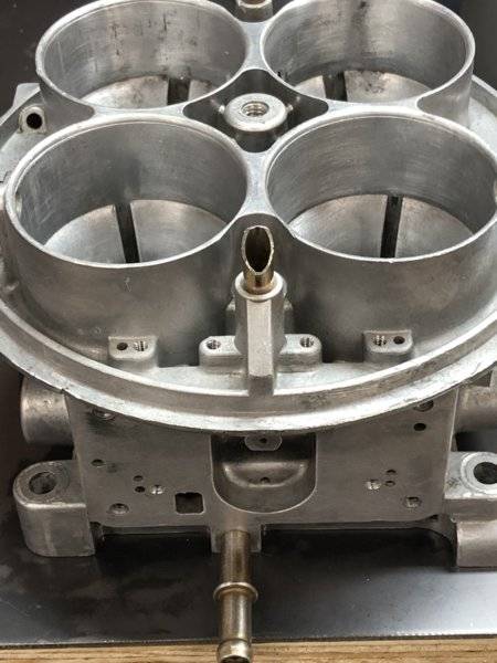

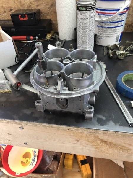

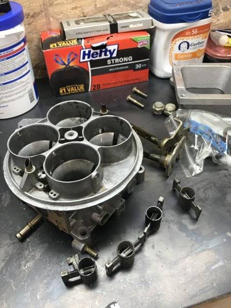

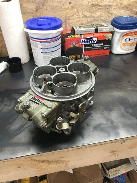

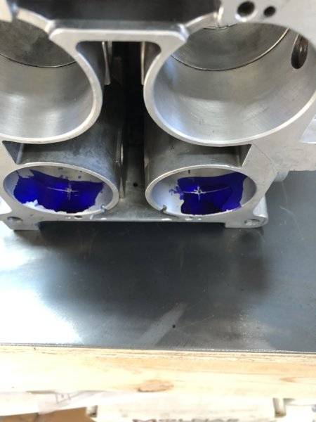

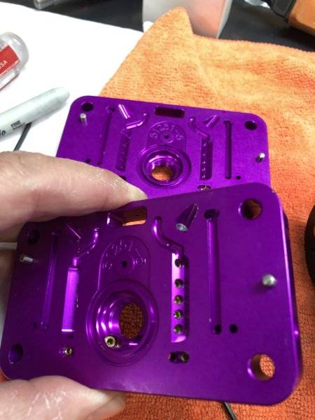

Mixing old with new on this 4575 Dominator for my buddies 500 cube stroker. Plan to test it on the roadrunner when it’s complete. Upgrades include 4 corner idle conversion, metering blocks, annular boosters, adjustable bleeds, slabbed throttle shafts with external linkage.

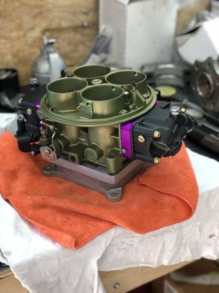

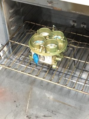

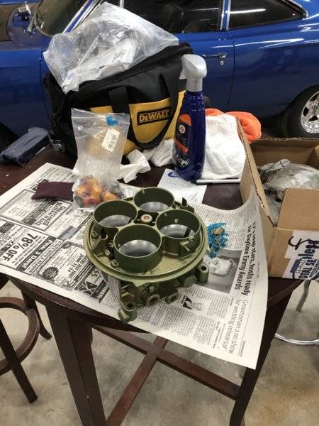

Eastwood powder coat, gold mixed with translucent green and then topped with satin clear powder

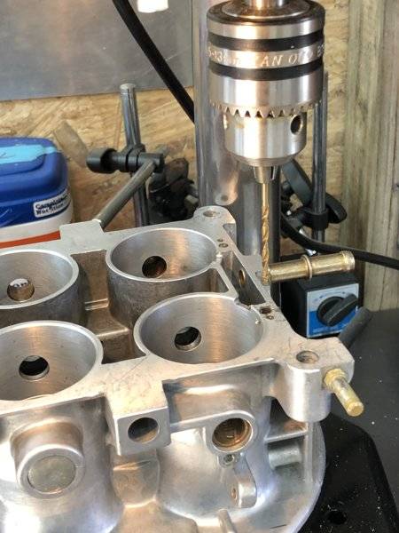

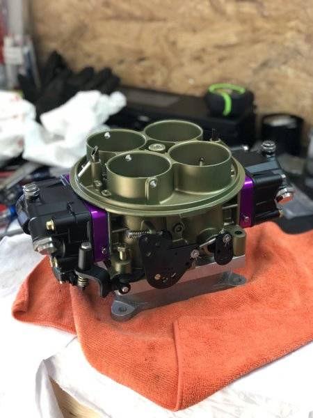

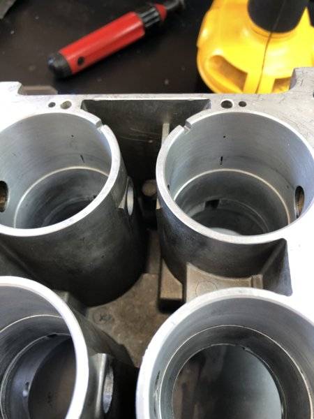

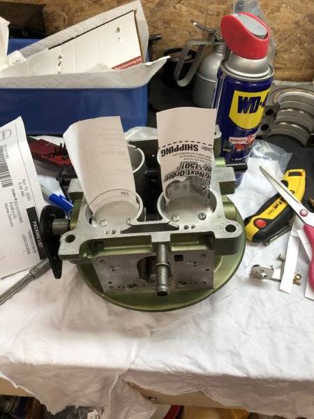

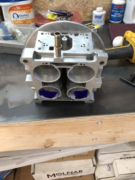

Drilled all the bleeds today and finished it up!! When I get a chance I’ll toss it on my car just to confirm the tuneup is good.
Took it for a ride today. Runs good, goes down the road like fuel injection. Jumped on it from a dig and put the car completely sideways in the road!
