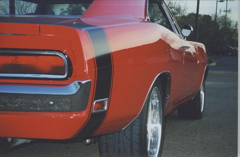

The guys that turn corners agree that with the hex size of 1.24, you cannot actually "over-spring" a torsion bar Mopar. I run 1.15s in my aluminum headed 440/493. Bilstein shocks and big anti sway bars. The car rides and handles very much like my 2015 Challenger R/T. It is firm but not harsh.
Love the picture Kern Dog and thanks for the information and opinion. Just pulling the front end this coming week, built support posts with wheels and installed them already. I am having a bear of a time getting the K member bolts out. Using a 1/2 drive socket, breaker bar and cheater pipe. Backing her out a few threads, squirt with penetrant, run back in...gaining a few threads every time but sure testing old muscles! Wish there was a way to get the penetrant inside the frame rail. Had thought about drilling a hole to be able to squirt inside to loosen her up. Have any of you drilled a hole to have access like that....or any other way to get those bolts free?

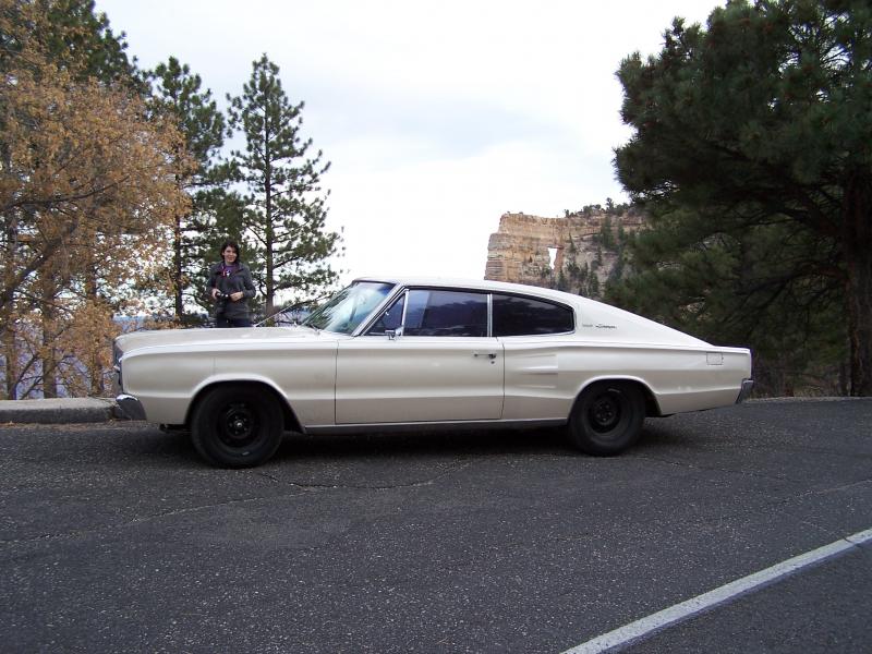

I had 1.08" (IIRC) torsion bars on our '66 Charger and loved it. It had KYB's so the ride was a little harsh but man was it fun to drive! It also had a 15/16" sway bar in the rear and 1.25" in the front.
That car was a 440 powered road trip machine that took us all over the Western US very comfortably.
On the other hand I have a stock '66 Coronet with .890 bars and a (IIRC) 7/8" front sway bar and it's like a marshmallow compared to our old Charger. I'm sure the Monroe shocks don't help any lol.
If it was me I'd be looking at 1.00"+ bars, GOOD shocks (FirmFeel or Hotchkis) and greasable LCA pins with poly bushings.
Pic of old Charger : )
