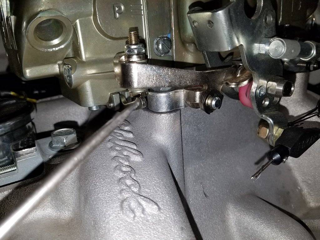

Yep check timing, and before you switch any parts on your carburetor, make sure the accelerator pump arm on the primary side is adjusted properly.... needs to move and give you a shot of fuel at the same instant there's any movement in the throttle linkage. You also need to be able to slide a .015 feeler gauge between the arm and the adjuster bolt head when at full Throttle, to prevent the arm from bottoming out the diaphragm and damaging it.(that's my screwdriver pointing at it)

Had to do this on my demon (purchased back in '08 when they were still a company!) I had a slight hesitation at first stab of the throttle as well
