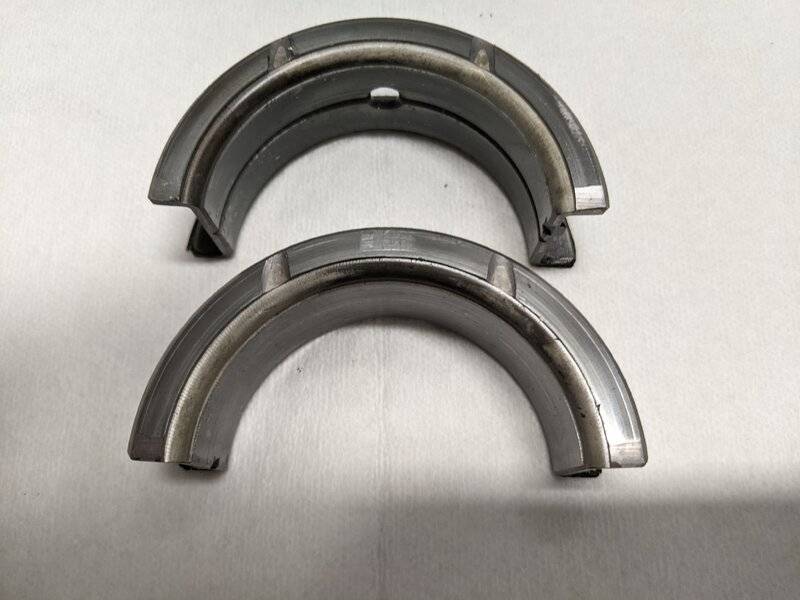

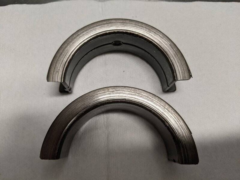

I've been doing a some P/M on my 69 Road Runner survivor over the winter & while the radiator was out, I figured that I'd pull the water pump, balancer & timing cover off to replace the factory timing gears and chain. Of concern to me was the plastic coated camshaft gear. In spite of the car's low mileage (33,000 mils), I'm sure that plastic wasn't meant to last 52 years. No teeth were broken, which was a relief, but when I pried the crank gear off, I noticed that there was a strong 1/16" - 3/32' play in the crank, front to rear which isn't good. The next step was to pull the oil pan and #3 main bearing. Once I did that, this is what I found....
Front face of the thrust of bearing...
Rear face of the thrust bearing...
The actual bearing journal surface of the crank & bearing are fine with no scratches or debris imbedded in the bearing. I started thinking about what could have caused this & the only thing that I can come up with is the previous owner cranking a cold engine that sits for long periods of time while pushing the clutch in. With the clutch pedal is depressed, it pushes the crankshaft forward which in turn puts pressure on the rear of the thrust bearing & if it's dry (from sitting), this could be the end result.

Just my 2 cents, but now that the crankshaft thrust face is no longer flat, the new "Flat" thrust
bearing will point load and wear fast because there will not be an oil film between the parts.
Those two notches in the face are for oil to lubricate the thrust face while the clutch is depressed
and now they won't be able to do their job. I would pull the crank and have it welded or replace
crank if your engine makes some serious HP. It will restore the end play and the flat face of the
crank thrust. The same thing happens on automatic cars if the end play isn't set right. It'll chew
through the thrust bearing and into the block! The reason I say to replace the crank is because
when they weld up a crankshaft, they don't stress relieve the heat affected zone, so cracks can
start in this area and you'll have a two-piece crank.
Steel cranks are welded all the time with no failures when done correctly on a crankshaft welding machine.
