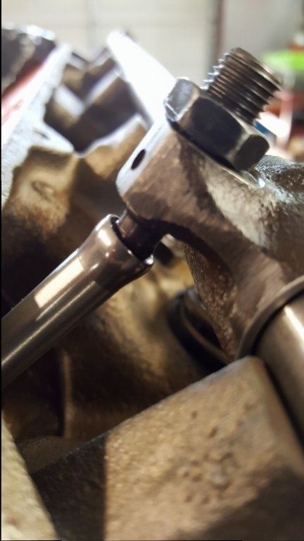

Preload set @ .060 Everything looks right on!
Spending the $30 for a checking rod is a must! I even used this one for checking "full open" specs.
I was concerned after reading that there might be two different radius on push rod balls, what exactly do I have? Also, with these lifters, they are hard to tell if they are made for 5/16 or 3/8.
So a little grease and the proof is in the pudding! Some machinist dye or magic marker would probably work too. Moving on!
