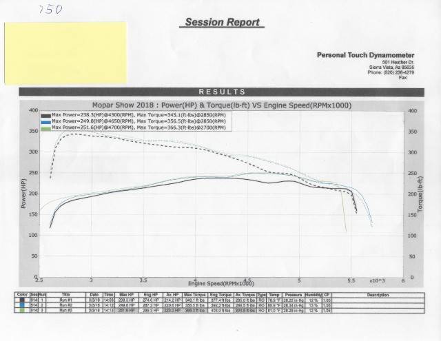

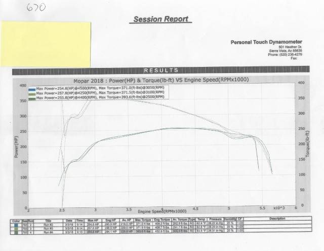

I had the chance to put the car on a chassis dyno last weekend at the HEMI Show in Phoenix. So I brought both carbs. Horse power was very close, but surprisingly the smaller 670 actually made a little more HP, and more torque than the 750 did. I was really surprised at that because the 750 feels stronger. But the dyno dont lie. The 670 had a bad dip in power right on the hit of full throttle. The dyno graph plainly showed it. The 750 had a much smoother pull, clean power curve all the way across the graph, probably why it felt stronger.
On the graphs around 5000 RPM there is a dip, I could even feel it. Felt like a stumble. Valve float? Ignition?
The 670
The 750
Did they log O2 (air/fuel ratio?) First thought is it may have gone lean, what is the fuel system? I think ignition or valve train would not have as smooth a dip, but also don't know what filtering was selected in the dyno results display?
He did not have any o2 sensing. It is using a stock style mechanical fuel pump. I should have been watching my o2 gauge after I felt that stumble the first time. I dont normally run the engine up to 5000 rpm, but next tme I do I will watch the o2 gauge.
