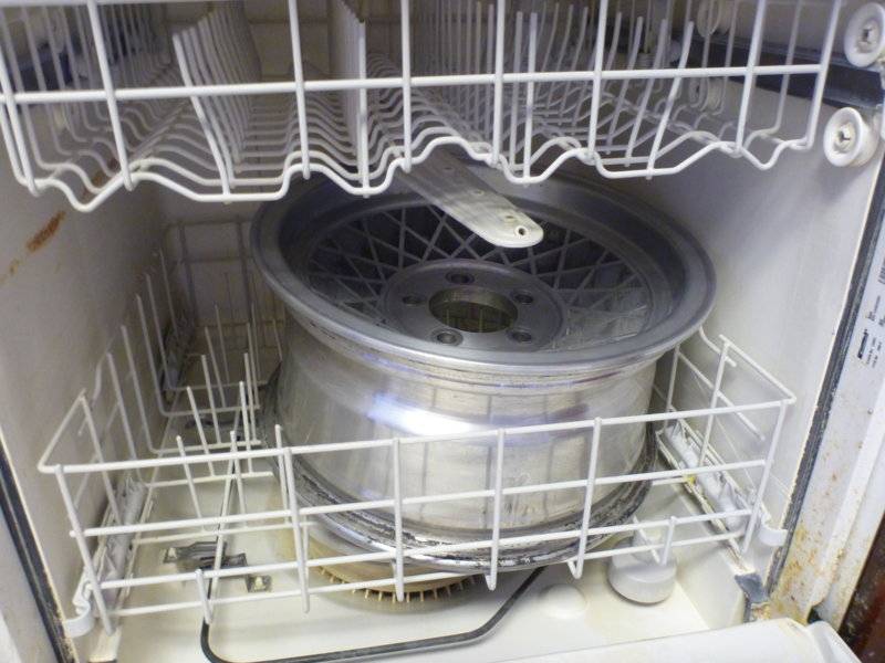

              Be careful.. no she didn't catch me, but our water turned my wheel light brown... beerestoration2017 653.JPG

                At the Detroit Autorama a few years back I was admiring a BEAUTIFUL 32 Deuce and mentioned the fact I liked all the "raw" aluminum (blower, valve covers, etc) and asked how they got it all looking the same consistent color. The owner's wife said he ran it all through the dishwasher WITH detergent. Now most soaps are Alkali so there will be a reaction with the aluminum. I didn't ask if they'd coated it afterwards but I think it would be a necessity to stop corrosion which, if you know anything about bare aluminum, occurs almost immediately.
