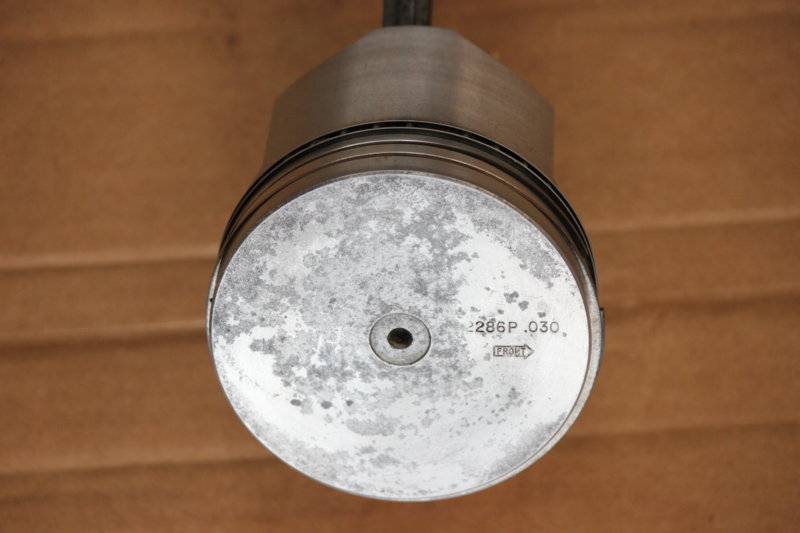

What was the compression height of the pistons used in the A12 cars? Supposedly the same as the 440 4 BBL's.
Do you want the exact number? Not sure. From memory, it's close to 2.03. Like 2.029, or 2.032 I have the original NHRA approved Speed Pro forged pistons. It measures 2.034 with calipers.
It is the same piston as the 68 and 69 4 bbl piston.
Thanks. I'm actually looking for a measurement of the production piston to compare with the L2310 piston that you have.
No. 2286P
I looked at some info regarding the "original piston" compression height. Says 2.031". But I did not measure it myself, that info is from someone else, but a trustworthy source, FWIW.

Oh, my mistake. Sealed Power 2286 that you measured at 2.034 vs the production 2.031. That helps me out. Thank you.
Yes. But I used calipers with them still mounted on the rods. So my measurement could be off a little.
@BSB67, I think your piston is a 2266 trw. Trw claimed that was a 10/1 piston (hahaha) at .092 down in the hole.
Trw sixpack forged replacement was L2355F, 022 in the hole, with a 2.061 c.h.
Trw had four different forged pistons for 440s back in the day, 2266, 2295 (dome),2355, and2388. I have weights, volumes and measurements from a 1989 trw catalog if anybody needs them.
Unfortunately, i don't have info on original 6pack cast pistons for the op.
Edit: that 2266 is literally the heaviest piston in my trw book, 880 gr. Plus or minus 10gr.,and a 225gr pin.

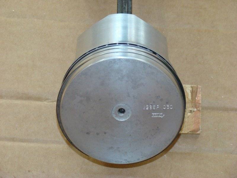

Suggesting I cannot read a part number and a caliper? Does this help you. I purposefully purchased these pistons in 1990. They have long since been unavailable. They sit 0.048" in the hole. I have the original bill of sale if you'd like to see it.
I was just going by what I could see on your post #4 on my phone. And there is no valid 2286 in my1989 trw book. If its later than that, or a sealed power, than I'm mistaken Sorry, I didn't mean to insult you, and I didn't have access to the better pictures you posted later. And I did say "I think".i didn't suggest anything.
All good. Looking back, I came off a little strong. My apologies.
Sealed Power. 1990 was probably about the last you could get these.

Yep. If you have a set of 2266s, with some planning you can get its 1.99 compression height to work out okay. It is a replacement for the 67 HP motors and will get you in the upper 9s with 915 heads and a 0.022 gasket. But what usually happened was they got matched up with 906 heads done on the cheap, 0.040 head gasket, and a 509 cam. Turd recipe.
But it's the 1.92 pistons that are impossible to work with in a NA application.
I never understood why, back in the 80s and 90s, they bundled these crappy pistons into discounted complete rotating assembly's. They were in all of the magazine's. It wouldn't have cost any more to put the 2355 verses a 2388 pistons in the kit.
where is the valve reliefs? the 6 pak motors I have worked on had valve reliefs from the factory.
They happened to be what's in the short block that I'm useing. Slugs! Lol
