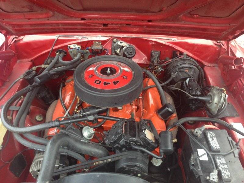

Can anyone tell me where the engine to firewall ground strap goes. Pic would be appreciated
Thanks
Its missing in the picture but I circled the hole on the firewall.
On the block it mounts on the back of the right hand cylinder head.
