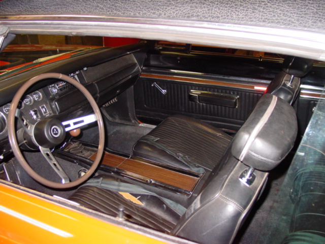

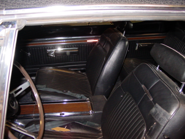

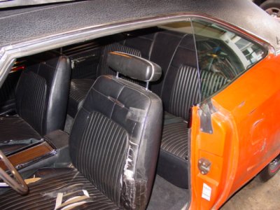

Here is what your car should have.

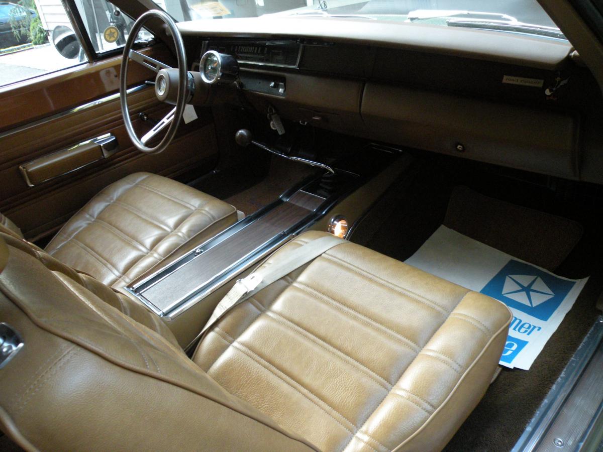

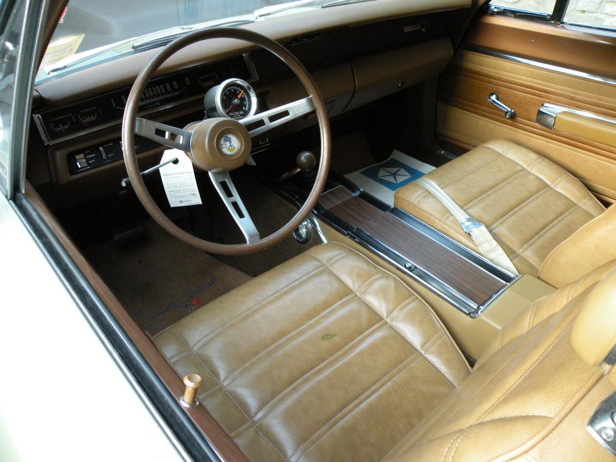

heres some for reference.a original a12

if i haven't said it before i will say it again that is one sweet a12 you got there chris what a time capsule i love it you should be proud to own that car i would.
Thanks, I do love it myself. From the 1st day i saw it in the summer of 69 and now it still is my favorite. I think its a keeper.:glasses10:

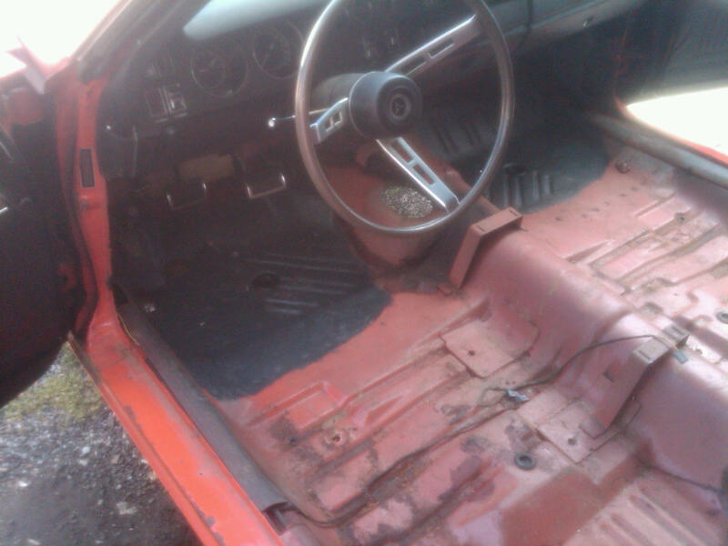

Factory bucket seat cars will have reinforcement plates welded on the floor pans to support the inside bucket seat tracks,easiest way to determine if bucket or bench car. Love the A-12 cars..... nice ride SSR
Yup, good reference pic of the plates.

THANK-YOU all SO much for all the information about what the original 69 A12cars should've come with from the factory relative to the front seats. It's extremely helpful and it's great that everyone wants to help with accuarcy. I found a pair of original 68 RR front bucket seats with good rust free tracks in a small wreaking yard in a remote part of Montana. They look a lot like the bucket seat pictures that RubyredSavoy posted but, w/o the head rests. I may just go ahead and use them and have them recovered and call it good. Can I assume that Ledgendary interiors or Year-One would have the exact vinyl seat covers to look correct?

Yes GF, Legendary has exactly the covers you need (better to buy them through Dante's Parts for a nice discount). To be correct, you will need to find a pair of headrests since the A12 cars all had them. By Jan 1st, 1969, it was mandated by Fed law that cars were to be built with headrests, all A12s were built well after that date.

I agree with the above. What Legendary won't have is the correct seat medallions that were used on both the fronr buckets and on both sides of the the rear seat backs. They are very difficult to find especially with the recessed backing plates that allow them to look recessed into the seat material. Legendary also won't have the steel backed woodgrain trim that comes on the top of the door panels and the back side panel area that was standard with the bucket seat interior for 1969. RubyredSavoy's interior pictures show these things.
