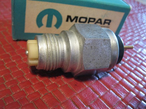

Can anyone recommend a neutral safety switch that doesn't leak past the white plastic body and comes with a black rubberized metal seal? I've gone thru several in the past 3+ years and it's always the same leak.
I'm considering an Echlin because it states that it's made in the US to the same oem specs. Part # is ECH-NS6562, costs $35 but does not show the seal and doesn't show it as another part. I'm tired of the china junk that's on the market and willing to pay for something that really works. Thanks.

Ray, this is an old thread. I was just wondering if you bought the NSS new old stock? Did it come with the seal? Did you install it with no leaks? Please advise.
Mat, Yes I will get it as new old stock, it comes with a seal and the original box. One of the photos of the nss shows that the part# is stamped into the metal collar. I just ordered it yesterday and will receive it 6/8- 6/13 via usps. Keeping my fingers crossed that this is the answer to the leak problem.
