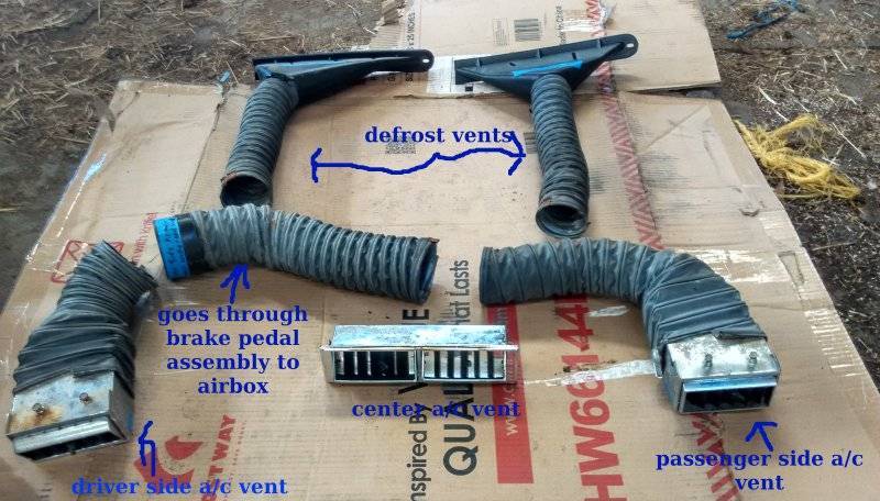

The two ducts on the lower left of the photo are what connects the ac box to the driver side ac vent. I'd imagine you can just run a single piece of duct tube all the way over to the ac duct instead of the two pieces. Pretty sure the duct goes through the hole in the brake pedal assembly.

I have not been able to connect the hose to the drivers side vent, there just wasn't room over the steering column. I'll have to check out the brake pedal assembly.

Hmmmm... so theres no formed plastic duct? When I got the car, I thought 'oh, it just needs a length of 'dryer hose', so I went to NAPA and got the correct size; least ways it was what fit the outlet on the box. I could figure no way to get it over the steering column... best look again, huh?

66 and 67 is a corrugated tube.
68 and up is a molded plastic tube

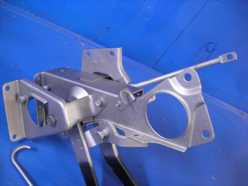

Big round hole is where the duct goes through..
Got over to see my car today - my pedals dont look like that... :( could be because my car is [regrettably] a [column] auto as opposed to have 2 pedals hanging down there like God intended! No big hole in my hanger. But...since I now know that there is no formed duct, I shall look harder finding a way to rout it over and around the column. Thanx again.

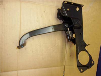

Auto pedal assembly should look the same unless plymouth and dodge had different pedals. I have 66 and 67 manual and auto pedal assemblies and both look like this.

Hmmmm... cant imagine theyre different. maybe I just didnt look far enough up/hard enough. I DID try and run my hand up under the dash where I couldnt really see to feel for that opening....

OK... got the car home today and got a GOOD look under the dash; found the big round hole in the pedal assy - thanx for pointing that out. HOWEVER.... there is NO WAY to get that ducting over from the outlet on the airbox, over the column and thru that hole...at least w/o dropping the column and moving a lot of stuff. Wiring and a column brace are in the way. THEN... the fuse box is in the way of connecting the duct to the outlet! There is a reason - nay 100s of them - that I hate a/c on cars...

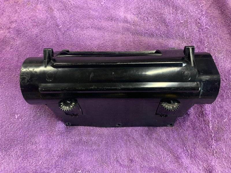

I'm a little late to this topic, but here's a pic of the AC distribution housing on my 66 Satellite. Not sure if its the same for a 67. Pretty sure this is what snakeoil24 mentioned in post #4. There is also a plastic tube that connects the passenger side AC hose to this distribution housing.

IS the same 1966 thru 1970
