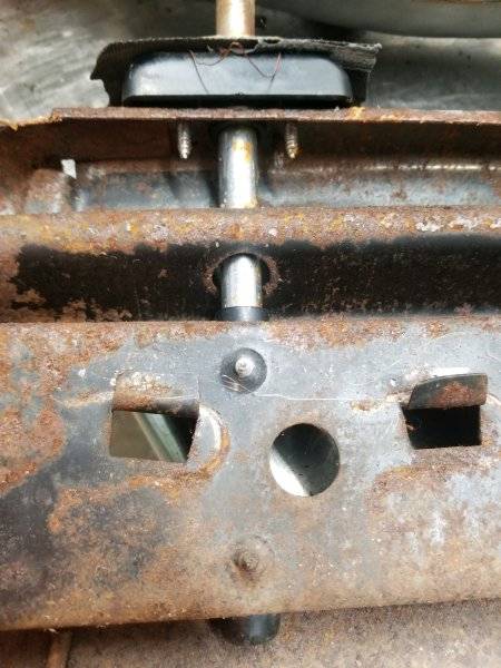

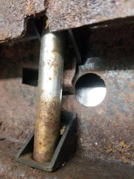

You will find your seat backs will have all the necessary holes, but not the hardware. In the attached pictures you can see the upper guide that screws to the top of the seat back, two plastic guides the headrest rods slide into, and a clip that holds the headrests up. You will need all of these parts plus the chrome outside bezels.
All the 68 frames I've seen have had the holes already punched. Just have to buy the headrest mounting kit.
