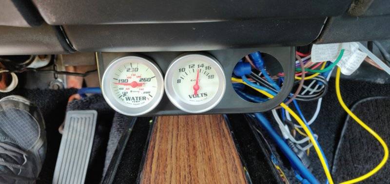

Hey guys, I recently added the three under dash gauges. Voltmeter - no problem. Temp gauge - no problem. Oil pressure, now I got a problem.
How do you hook up additional under dash gauges and still have the dash oil gauge work? I currently have an electrical sending unit and gauge in a 69 charger. If I join them together, the aftermarket one bounces all over the place. Is there any way to have them both working? BTW I'm running the Equus three gauge setup.

IMG_20190921_132417.jpg View attachment 838328

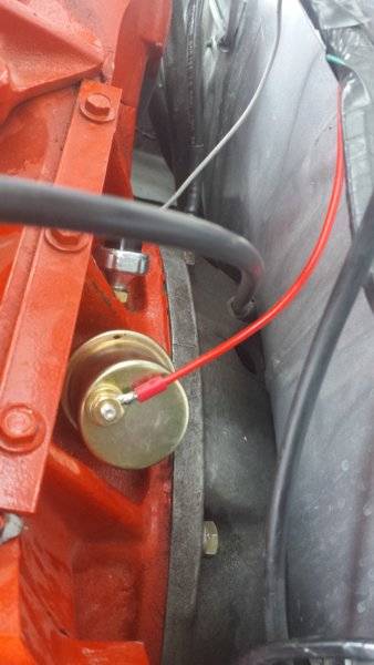

Should be 2 ports on the top, back of the block. Here is my setup. Stock sender and aftermarket sender.
