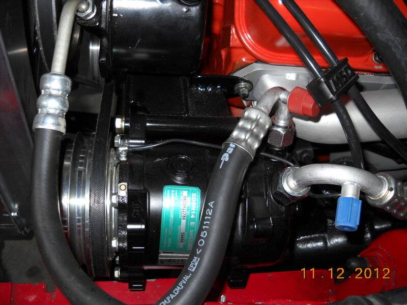

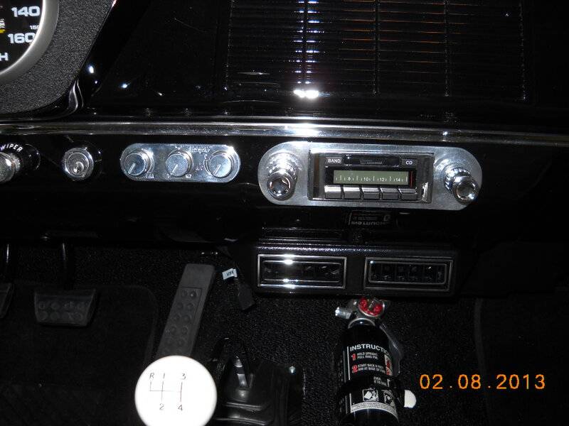

Back in 2012 I had a local hotrod shop install a Vintage Air Unit in my 63 Fury convertible. They completely removed the stock heater box and built a custom bracket to mount the compressor low on the driver's side. They used a GEN IV MAGNUM, model # 671400-VUZ. They cut the dash to mount the control panel ( #491210-RUA) and mounted the vents below the dash in the center and on the left and right sides. My car is a restomod and I'm not at all bothered by originality.
After 8 years and many hot summers and miles, I have nothing bad to say about the Vintage Air unit. It works great, even in a drop top, and I've had no problems with it.

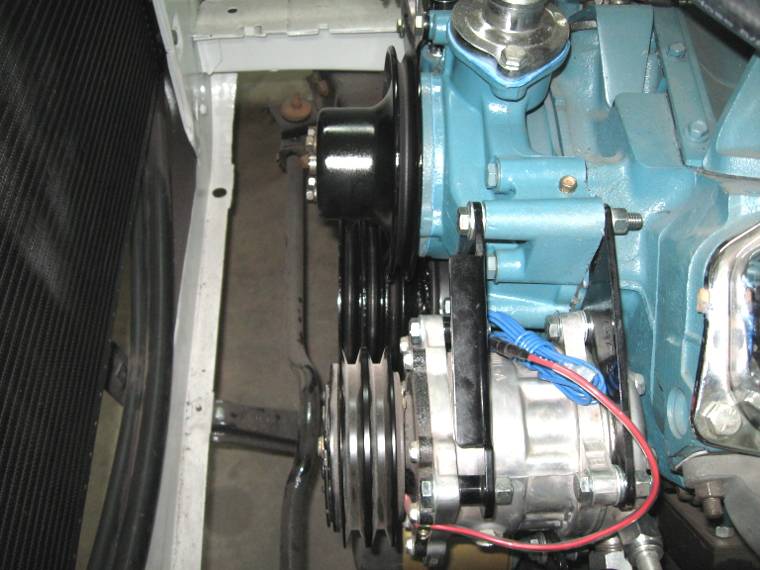

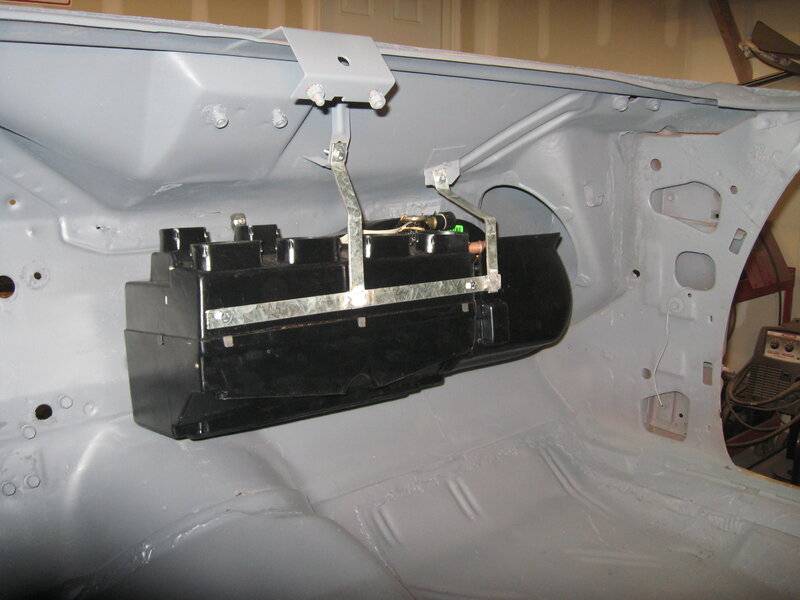

Installing a Vintage Air unit in 62-65 B bodies is pretty straight forward. Requires a little fabrication when it comes to mounting brackets for the unit itself but that isn't difficult. Everything else is just a bolt on really. Here's the unit mounted on the passenger's side of my '64 Polara.

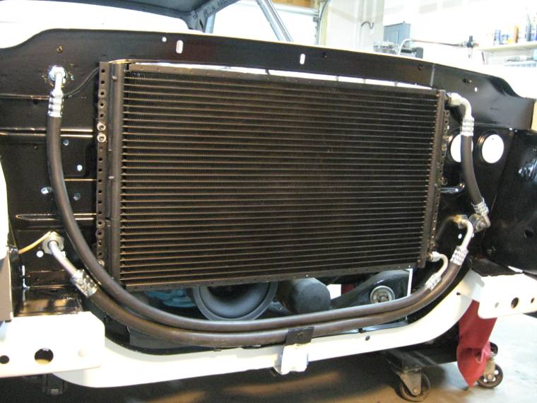

Picked up this condenser on E-bay brand new for $50.

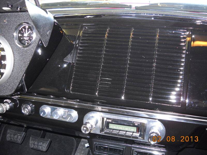

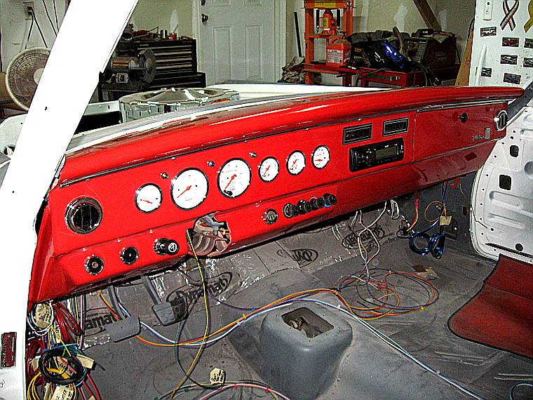

I modified my dash to allow for the vents but you can mount them under the dash without any mods if you want.
Used a low mount bracket for the compressor to keep it out of the way. Not using power steering so I had the room.

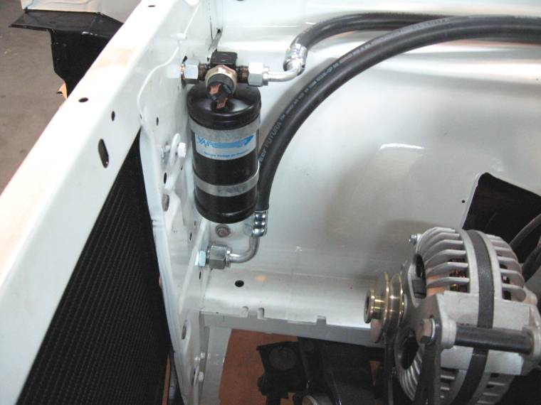

Mounted the dryer on the passenger's side of the radiator support and ran the lines to the evaporator down the passenger's side fender.
