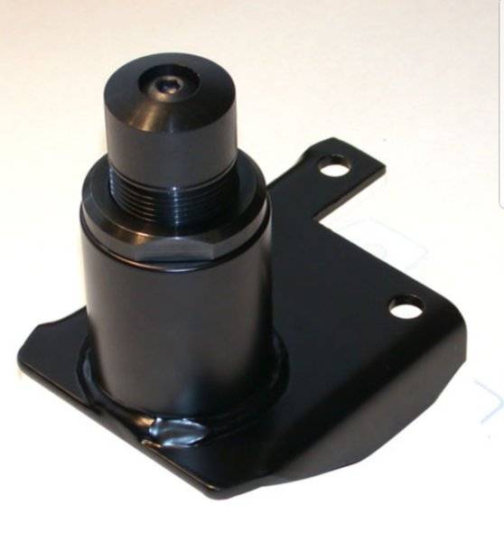

I would like to know a "starting point" adjustment for when I install it.

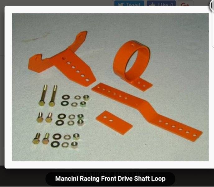

Got their driveshaft safety loop coming too.
It's the one that attaches to the transmission mount.

I've had experience with the adjustable pinion snubber on a street driven car, and even at it's lowest setting, any decent bump would cause it to contact the body.
For street driving I leave a half inch. Racing is usually touching.

Did you have the pin through holes adjustable snubber or the screw adjustable type I got?
How did it affect traction when set up and used at the track?

The same one in the pic you posted. Do you have a dana? Not sure if it matters, but I do.
It was set to give as much of a gap as possible, and at any decent bump, there was contact, which prooved to be very uncomfortable, so I removed it.
I seem to recall the old Direction Connection manual suggested 1" to start. Tighten as needed. The snubber will contact the body from both rotation of the diff (which limiting the rotation of the diff is a purpose of the snubber) and from suspension travel. Mine used to bang on the street.

For me I hear it on the larger bumps only. XHD springs and MP shocks. Mine is the same except it's for the 8 3/4 (fully adjustable). The pinion snubber is Mopar's version of traction bars.
I have the exact same snubber and I'm going to install it. When you say 1" do you mean unscrew it so there are 1" of thread exposed? or when car is level, unscrew it so there is 1" of clearance from floor board?
Agreed. 1/2 for street, you can adjust it down if need be. But IMO, a 1/2 is a good starting point. Then, just barley touching for the track. The rubber subber should make contact squarely against the floor.
The dimensions being suggested are from top of the snubber to the point of contact (i.e., floorboard). Yes, the car should be sitting level on the wheels when the snubber is adjusted.
I've run about 1" snubber to floorboard clearance on street cars since the early 80's (per Direct Connection book). I rarely have had bumps make it contact (super stock springs), BUT I have pounded the floorboard hard enough that I need to add a "Hemi pinion plate" to the floorboard. Dropping the clutch at 4000rpm will do that. I mainly added the pinion snubber to prevent wheel hop & it worked.

I agree! It is inexpensive and effective. As mentioned earlier, adding a plate to the contact area should be done. I did forget about that. Sorry.
While it is easy to just quickly mention a much more expensive & effective set up, it doesn’t deal with the OP’s current position and question.
What the snubber did for me was eliminate the occasional axle hop-hop-hop..which is great, but my car still struggles with traction on the street tires..as to be expected. I drove around quite awhile with the snubber touching the floor and the slightly harsher rear didn't bother me, I currently have it about 1-1/2" down for family cruising. I personally like them either touching, or far enough away to still stop the hop but not smack the floor on every bump
