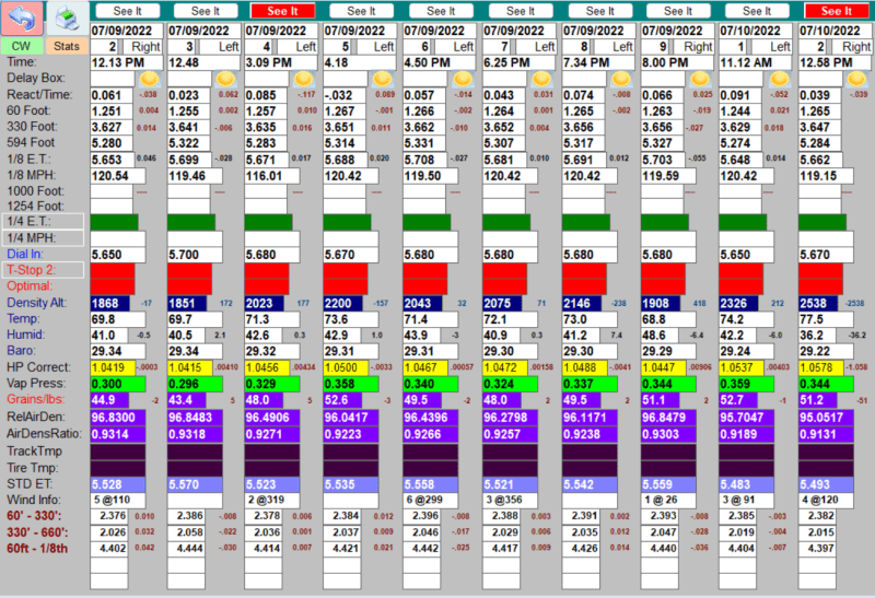

Heres a sample. Track was better on Sunday's 2 runs. I deep staged on run #10. It would've been 1.24X 60ft.
Doug
