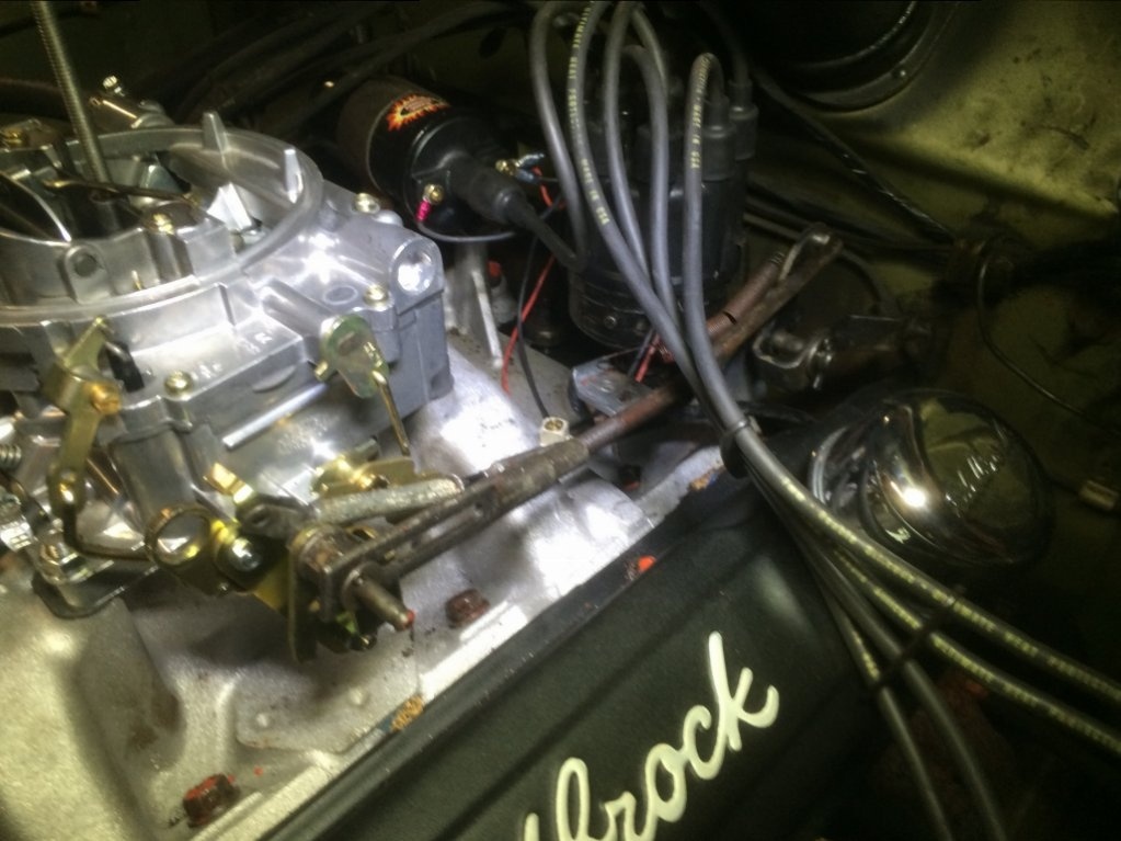

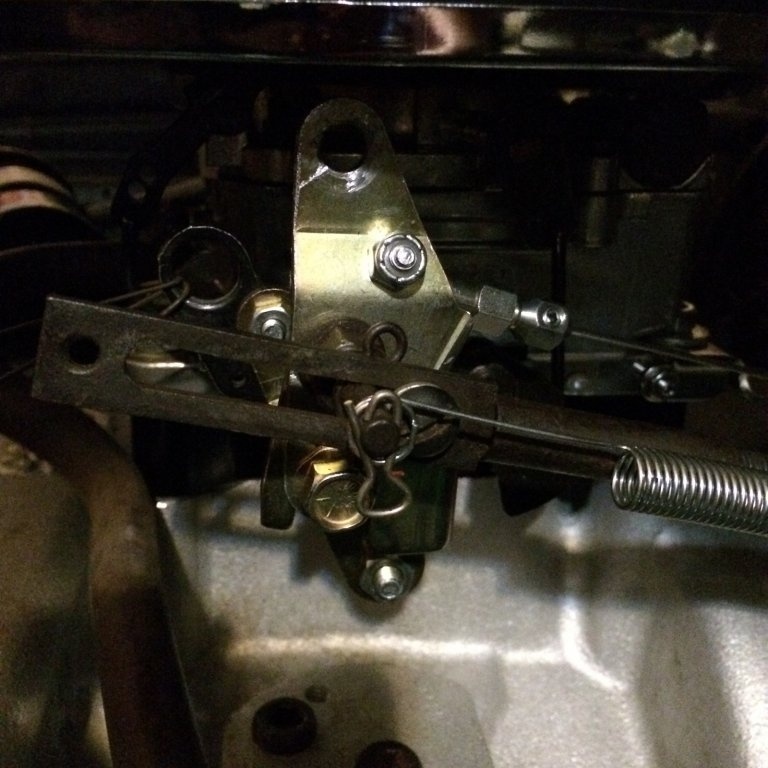

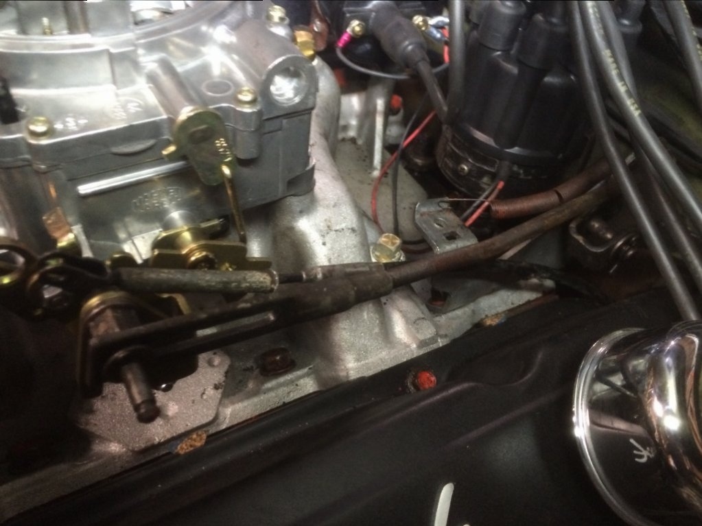

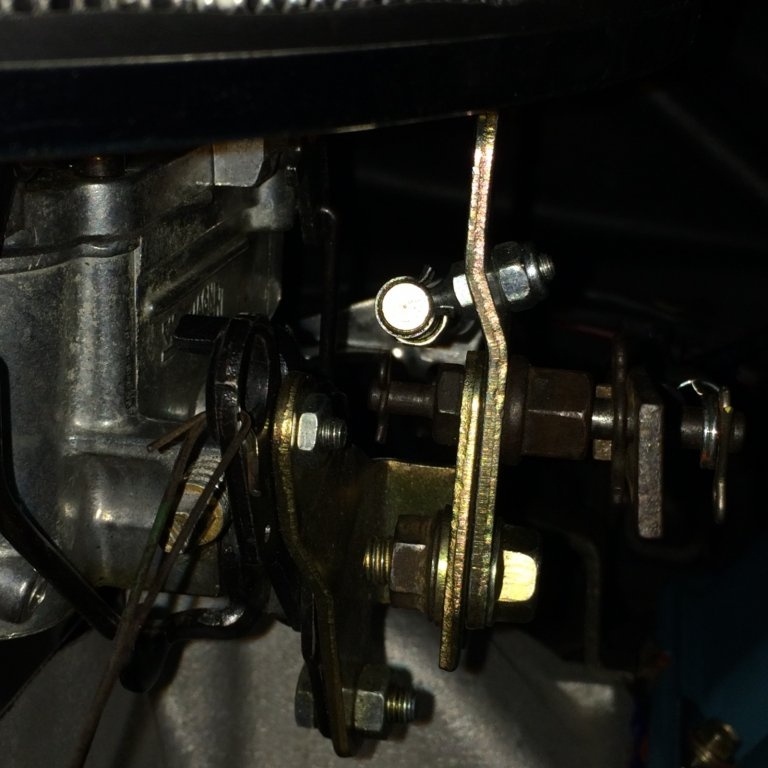

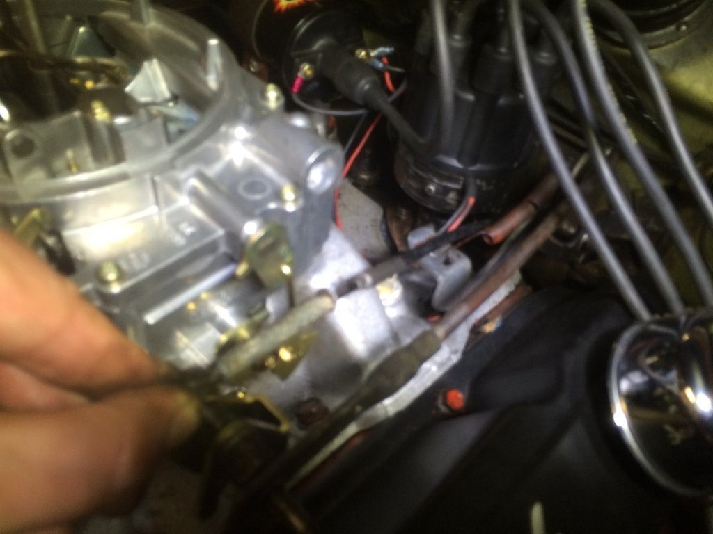

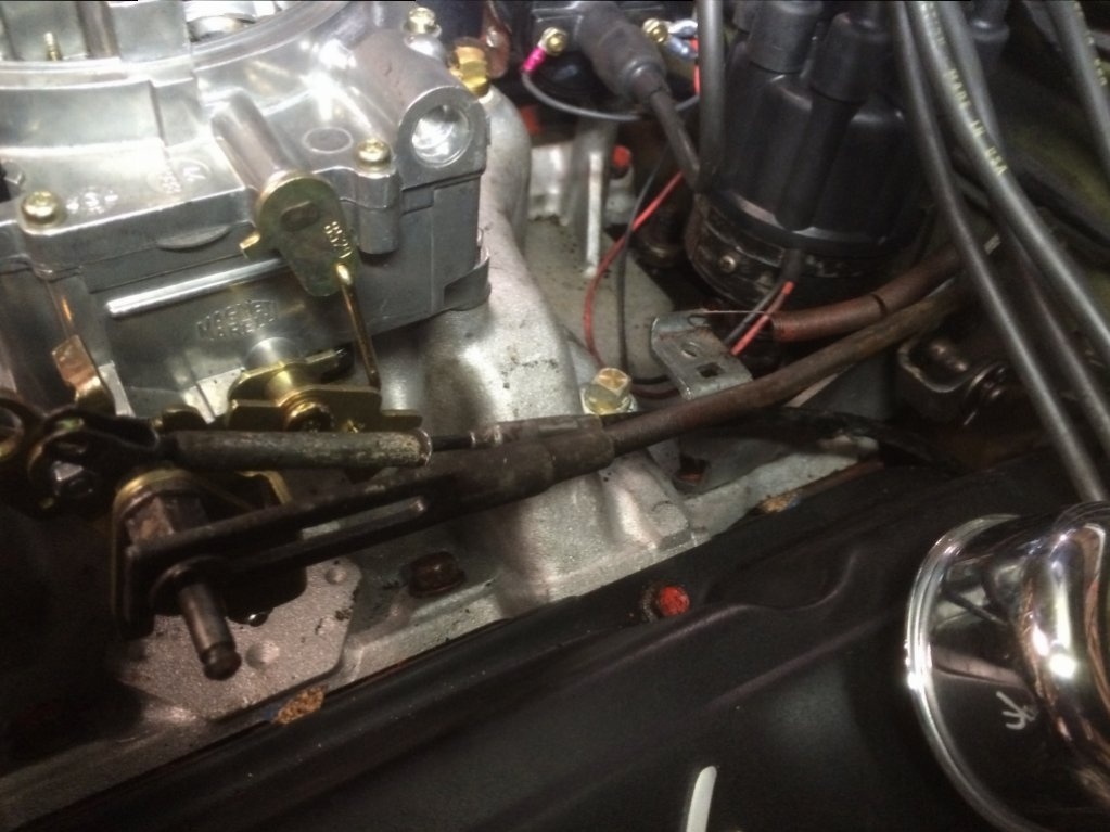

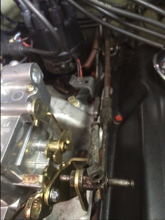

Here are some pics. After trying what Miller suggested, it seems like with the new manifold and carb the throttle cable just doesn't fit right - I can't get the metal bit into the bracket because I can't push it back through the firewall far enough. Is it as simple as cutting off some of the sheathing of the throttle cable? Here are some pics...
No, no cutting on the housing. That would turn your cable into junk.
You can't push it back through the firewall, because that end of the housing is 'fastened' to the firewall. That's how it mounts in.
From your pics (those help!), appears real close, within an inch. Reach back on the housing about halfway, and 'flex' the housing into an easy curve, not bent. Should be able to move it to one side, or the other, that will put the clamping metal sleeve into place. Then, simply get the clamp loosely on.
A lot of times those throttle cables are made a little too long, for flex, and just need to force them into place.

I had the same problem. Just building on what miller and Darthomas are saying, here is the setup that works for my car. I happened to have a second 1481 adaptor bracket, which served as a donor for the extension which was needed. Lokar throttle cable setup. WOT is now tire-shredding fun.
The determination of that exact spot was actually a complex calculation involving extensive 3-d modelling. Ummm, in reality I just got lucky!
