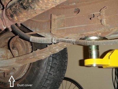

Here is a picture for reference - not the greatest, but hopefully gives you an idea. In the picture, at the lower point of the backing plate there are two slots - one has a dust cover (the one towards the front) and the other (partially obscured by the axle bolt) is open.

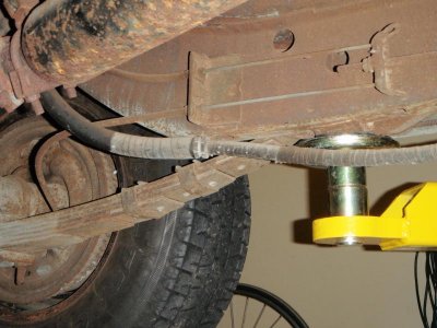

Added a quick pointer to the picture . . .

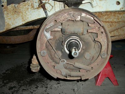

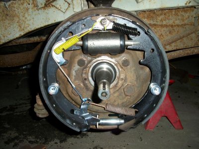

just doing the brakes on my 66 charger. not sure if the adjusters are factory but they were on it. 10 x 2 1/2 on all corners.100_0550.jpg100_0551.jpg
just doing the brakes on my 66 charger. not sure if the adjusters are factory but they were on it. 10 x 2 1/2 on all cornersView attachment 227223
That is most likely what he has, and those are automatic adjusters. Obviously the back brake's are going to look a bit different with the parking brake hardware, but the adjuster clip/lanyard and star adjuster should be the same.
Most of the cars we are working on have automatic adjusters..... '66-'74
