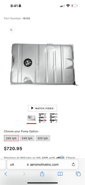

Is anyone running this setup? My only concern is it only has -6 an fittings. Going into a 70 RR with a 496 dynod at 650+. Street strip car. Thanks!

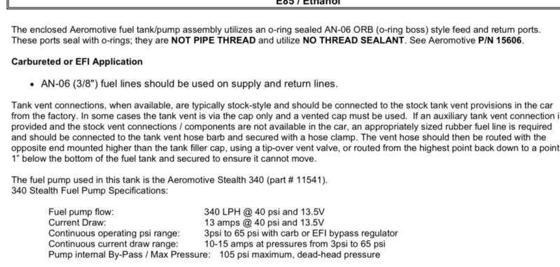

This is all it says on the website. I tried emailing their tech support a few months ago but never heard back. (Strike One).

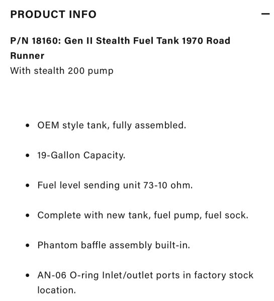

The info you supplied was for a 200 lph pump. They have bigger pumps listed, which would likely have bigger fittings.
On their Website, go to the bottom of the page and all the way to the right under Resources and go to Installation Instructions for the tank you are looking for. It will tell you the lines and fitting you need for the size pump that’s in the tank.

Per their website the 200lph pump is too
Small for you application. The 340lph seems more right-sized based on your 650+ hp. But the recommended line size is also -6. When you go to the 525lph pump, they recommend -8 lines.
